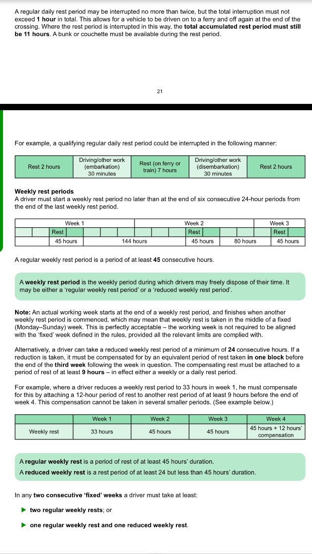

BUT As I understand, “Weekly rest periods
A driver must start a weekly rest period no later than at the end of six consecutive 24-hour periods from the end of the last weekly rest period.”
Therefore the 144 hours can only be achieved when ‘double manning’ over 6 days.

6 x 24 periods does not refer to 6 shifts - in fact the regs do not mention shifts or days as they work in hours
ROG, with all due respect, you’ve answered yourself well. 6 x 24 = 144.
The Law is quite clear, “A driver must start his weekly rest period no later than at the end of six consecutive 24 hour periods (6 shifts) from the end of the last weekly rest period”.
So I disagree that Trampers can do ‘7 or 8 shifts legally’ as you claim.
The Law is quite clear, “A driver must start his weekly rest period no later than at the end of six consecutive 24 hour periods (6 shifts) from the end of the last weekly rest period”.So I disagree that Trampers can do ‘7 or 8 shifts legally’ as you claim.

Sorry ROG, I disagree. You cannot do 7 consecutive shifts as your example shows. As the sixth you’ll need a 45 (weekly rest) as per Regulations (Law) Please refer to my attachment above, headed ‘Weekly Rest Periods’. It’s crystal clear my friend.

Ok, so why 7 shifts are illegal; Simply the fact that they are consecutive. Please, please, please read the regulation I posted headed “Weekly Rest Periods” it’s CRYSTAL CLEAR.

It states that a weekly rest period must start no later than 6 x 24 hour periods (144 hours) - it does not state anything about shifts or days so please explain how you are reading it

I have a feeling that Honestscott76 is reading a 24 hour period as being a DAY so is therefore thinking that the max is 6 days with one shift per day between weekly rests … I could be mistaken …
