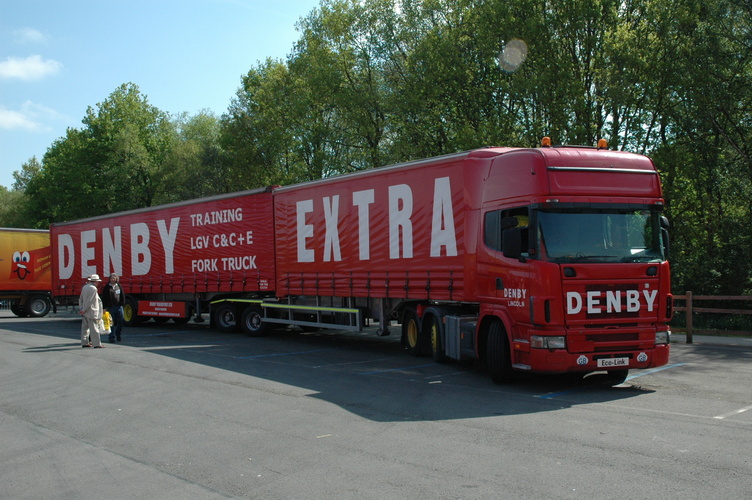

Stan took his around the northern track and showed it only needed an extra foot of side space to make a normal left turn at a normal junction. Stan was well before Debys attempt, Denby added a mid steer on the trailer that’s about it but let’s be honest
Drivers can’t be trusted with a normal set up who’s gonna trust anyone with that
B trains are compromised by the second trailer imposing a load on the axles of the first trailer so pointless for decent gross weigh capacity.While the Stan Robinson example shown was a proper A train type set up.While the double artic is probably excessive for general use here anyway with the Scandinavian type drawbar being the most practical LHV type set up.Which hopefully seems to be the way it might go if the pro rail lobby can be sorted out ( doubtful ).

Seen this the other day about Denby’s proposed B double. youtu.be/mM8KRz__DAc

Carryfast:
You do talk some crap, they have these in Australia , the A and B trailer A , both have tri axle trailers and GVM 90 tonne … there is no impact on the overall load capacity over the B trailers axle.
Carryfast:
Let’s get this right.You think that a 9 axle B train has the same gross weight capacity as an 11 axle A train. The only reason that the A train,would have the same gross weight as the B train,in that case would be because it’s being artificially limited.While 90 t gross on 9 axles ? sounds like a joke to me in that regard anyway.
You need to think again about the difference between train weight v combination weight.In which the former is all about the fact that the towed trailer imposes no load on the axles of the towing vehicle/trailer,unlike the B train or close coupled drawbar type.
Why would 90t gvw on 9 axles be a problem? Many other countries have higher axle weights than the UK, 12R/22.5 doubles could easily raise a trailer axle gross weight from 8t on super singles to 13t alone…
