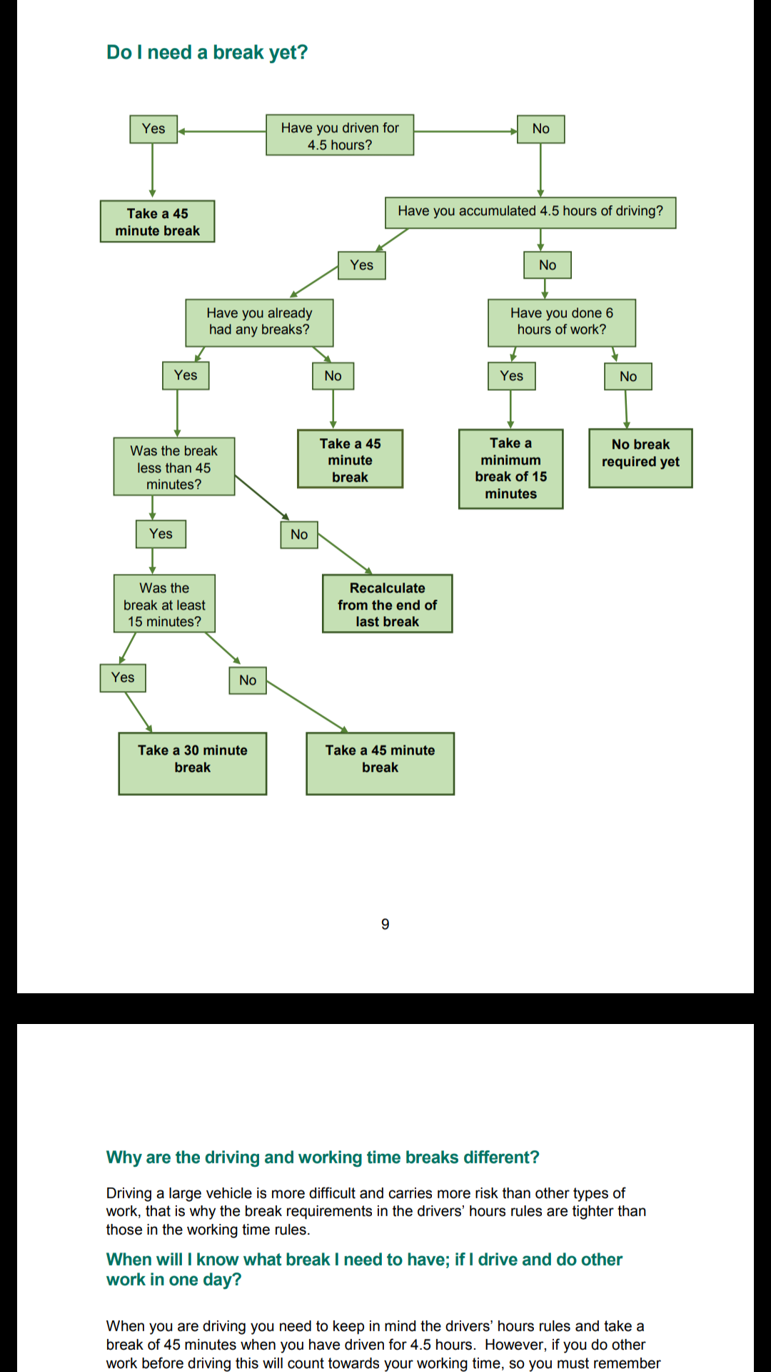

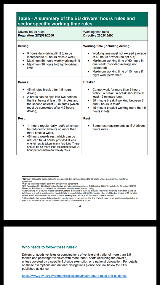

A few questions badly worded in one of the exercises including one regarding WTD. Options were 10 mins, 20 mins, 30 mins, 45 mins. A few minutes ‘debate’ following me saying that the question was badly worded and the correct option (15 mins) was not present. He would not have it that a 15 min break reset the working time clock and held that if you took a 15 minute break after say 3 hours then you’d have to take another 15 minute break 3 hours later. Ended it by saying to him ‘I’m right, you’re wrong. Just look at the WTD rules on the government website’.
He said that’ll he’ll check it tonight, bet he doesn’t. But then again he might, I outscored the rest of the group by a decent margin in the questions which should indicate that I have more than reasonable grasp on the subject matter.
Our lot are exactly the same.I’m forever getting infringments for not having half hour.Told them it’s 15.But they are’nt listening.
15 mins resets the clock but if your working day exceeds 6 hrs you need another 15 (30 if it exceeds 9hrs.) followed by at least 1 more minute of work before end of shift.
