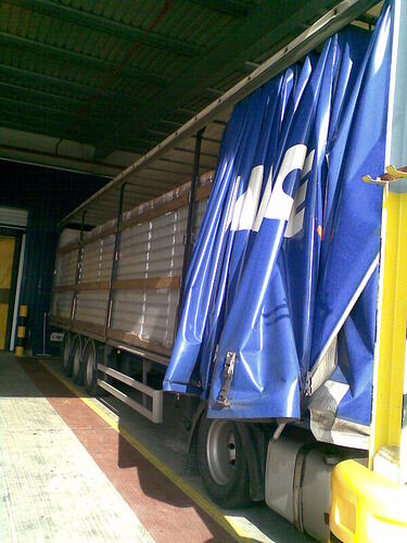

Would 2 internal straps restrain 52 pallets of corn flakes!

I am so glad I’m off the curtains. It really is ridiculous. It’s getting as bad as Germany now. Do they not realise that strapping some loads can do more harm than good. I took a cobelfret trailer to the new river island dc at Milton Keynes a couple of years ago. It had 2 flat pack conveyor belts inside. The whole trailer went 9 tonnes. It had 18 5 tonne straps lashing all the ally frames to the floor. Both frames were a write off. The contractors were not impressed. It’s about time load bearing curtains were made standard. Then just go back to strapping the back palletts
Best post so far.
In my opinion, i think we either do this properly like the germans, i.e proper trailers with lots of hooks for straps, side boards, rubber mats etc or we go back to how it was, not this half hearted atempt where all people are doing now is using a few extra internal straps.
In response to the OP, no i wouldnt of bothered strapping it, just the last row. Where i work you’d more than likely get sacked for refusing to take a load.
^^ This
I mean, come on, where the hell they going to go, how they going to go through a curtain? It’s bloody cornflakes for gods sake.
If he was permanent, he’d be in for a ‘chat’, if he was agency, it’d be the last time he came in. Hope the football was worth it.
I’ve posted before, but there’s a place that does toilet rolls near the reebok, and they insist you cross strap every 3rd row of pallets of toilet roll. They are wedged in at either side causing a slight buldge in the curtains and rammed in from the back doors (ooh err) to get the last pallets in, so literally no room to move and no weight…
Also, when you do x-strap every 3rd row, you can’t tighten the x-strapping because it may prevent the last ones coming in from the back and you’d then have to undo them all :unamused:
They told me it’s because they had a trailer go over, so now insist on it… :confused:
Where I am now is the exact opposite, no straps at all, I finish Friday.
those toilet rolls do move, and it’s a pain in the arse if they arn’t strapped right. the pallets are much bigger than the load, therefore there is an 8" gap between each stack.
they don’t realise that the correct stacking of each pallet would make a huge difference, but they could save a lot of money by buying the correct size pallets.
management. :laughing: :unamused:
Been told off already for trying to “secure” pallet’s of aluminium sections with straps. Even not tightened as they would damage the product. They didn’t know about this vosa thing and suggested I was dragging the job out :frowning:
Spose I could ask the boss for a statement on company headed paper saying no straps to used etc but doubt it would help… :astonished:
This is correct - but a load that isn’t restrained can do a lot of harm to itself, the vehicle or worse. if the product is ‘fragile’ it should be packed in some kind of stillage or frame that can then be restrained properly.
I was at a furniture manufacturers last week where they make school desks and that sort of thing. these are loaded into box ‘drop/demountable’ bodies and the drivers come in and pick them up. For years they have been loading the ‘containers’ this way - the loaders don’t secure anything (how can it fall out of a box?) - the drivers can’t secure it once it is loaded.
First thing the drivers complained to me about was the amount of damaged product when they got to where they were going and unloaded it. Apparently they bring ‘a large amount’ of damaged and broken desks and chairs etc back each trip.
I suggested try restraining the load as they load it - apparently the MD says this will take too long and they should just drive more carefully. They actually blame the drivers for the damage :unamused: An extra hour in loading time would probably increase the profit margin dramatically judging by the pile of returned items I saw in the skip.
of course the potential big problem is a load shift inside the box that causes roll-over … :open_mouth:
Load bearing curtains are great until the load inside shifts due to braking, sudden direction change or unexpected incident - all falls against the curtain which does a lovely job of holding it and the trailer/vehicle goes over instead.
Scroll down to section 16

Scenario 1
52 pallets of shrinkwrapped Crunchie Nut Cornflakes.
Answer: A variety of materials are suitable for restraining palletised loads. These include chains, steel
wire or fibre rope, webbing lashings and webbing or rope nets.
Problem: HSE will not allow a driver to climb on his trailer, how can he cover it with a net?
Answer: Rope or webbing nets are suitable both for securing the cargo to the pallet and for securing
the palletised load to the vehicle.
Empty pallets should be restrained and secured to the vehicle. This applies even if carried on a
vehicle where the height of the head, side and end boards come above the height of the empty
pallets because the wind can easily blow them out of the vehicle. (Only in the world of H&S make believe)
Shrinkwrap, Signode metal and plastic strapping has been used quite successfully for many years, according to the recent publications these are almost obsolete.

I have mixed feelings on this subject (load securement, not imitation lorry drivers :laughing: ) I think that things are getting out of hand and that there are far too many rules and regulations that exist only because somebody has a job making up rules and regulations :unamused:
I the past I’ve moved many products inside curtainsiders without a strap in sight, I’ve also had loads that require lots of straps, the same on flatbeds, some stuff needs chains and/or straps, some stuff only needed roping, sometimes using every hook, sometimes just thrown over to keep the sheets tight (not the flysheet of course :laughing: ) I’ve moved 25ton coils in a coil well with only a sheet and gravity holding them on, every situation and every load is different. Cornflakes in my opinion do not need strapping, except maybe crossed at the back just in case I’d drag raced away once too often, but as things stand now, if the rules say that every pallet must be strapped, then every pallet would get strapped, now matter how silly I think that is personally and while I was poncing about strapping up, the clock would be ticking and the wages would be going up :wink:
chester:
Lad at work had a bit of a drama, he was told to take fully loaded double stacked trailer which only had two internal straps around the rear pallets!
He was unable to use more straps has all the rest of the internal straps were tucked behind the headboard and trapped by the double stacked load.
His reasoning was the clampdown of VOSA and unsecure loads, and it was his license. Was he right?
He didnt take it out in the end and got an early knock off, traffic office dont seem to bothered about it as another driver took it out.
So thats 52 pallets and two internal straps over to you guys what would you do?
