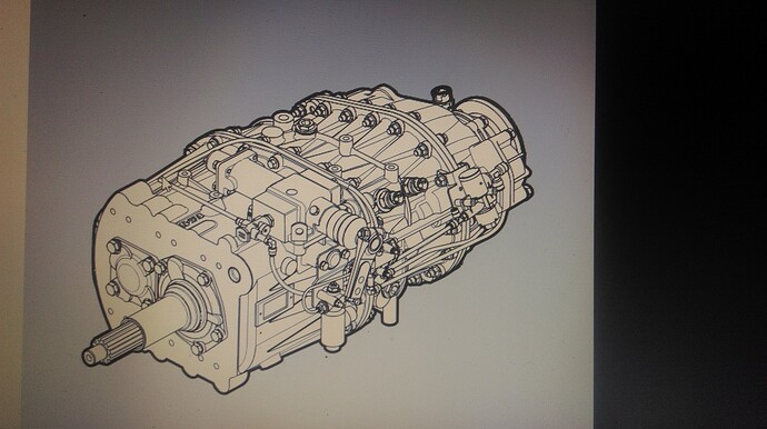

Hope my attempt at adding an image works cav
In the DAF it isn’t a knock through ,it is a 4 over 4 with the range switch on the lever…It is generally a reliable little box ,though not often specced…Generally found on sweepers,though the odd rigid has it fitted ,but it is rare …Example warburtons have 1 in their fleet where I am ,the rest are ZF 6 speed manuals ,with the 6 speed astronic lite superseding them…Yes it is fully synchronised…and will probably have the crawler…

Ok sorry for my incorrect use of terms the box has eton stamped on it and the gears are what i understood to be 4 over 4 ie 8 speed. the switch i thought was termed splitter changes the "range " from the lower 4 gears to the higher 4 gears when flicked up or down. I have purchased the vehicle yesterday and drove it back to my yard thats it. it has a test,6 wk inspections, insurance and tax. I have an O licence and need to find a fitter to do my inspections. We ran our last HGV a scania up to 2006 since then we have been running a 7.5 tonne Merc. I need a HGV fitter for this bigger DAF as my 7.5 tonne fitter is not happy working on bigger stuff. . I have rung two fitters this morning and booked in with one to give her the once over. My guys are on tidying up the paint work today. Apologies for vague description but I was only after some advice on an old truck as Im not a professional truck driver myself.
I’d guess it’s you who deserves an apology.Firstly it’s probably fitted with an Eaton synchro type box which is news to me . :open_mouth: While from the info available the 55 series certainly does seem to have a nine speed option in that regard.While closer reading should have said to me that you were talking about a mistakenly described range change. :blush: :blush:
So there we have it probably an old 55 with a 9 speed Fuller S (O) type box. :open_mouth:
If the rest of the wagon is in good condition maybe get it looked at by a DAF agent and if needed maybe look into the possibility of a factory exchange box. :bulb:

Is it crunching when you flick the switch and move the lever in to neutral ■■? Or is it when you attempt to select 4th ■■? Reason I ask is …The range won’t change until you are in neutral, so if you go for a drive and when you wish to change down to 4th,press the clutch ,put the lever in to neutral ,leave it in neutral for a few seconds it will drop in to low range .Does it sound ok yes or no …it no then you will have a range issue …Then select 4th,does it sound ok ,if no then syncros on 4th have failed …They will generally fault more time on the down change than the up change ,as the synchros are working more on the down change …If your guys can do a 7.5 tonner ,then an 18 tonners isn’t that much different ,apart from full air brakes where as on a DAF 7.5 tonner it was air hydraulics

Unless some has messed with the range protection ,it won’t let you change down at to high a speed…Though frm what you say it is indeed the range at fault,the syncros have what looks like banding on them ,which slows the bulk ring and it can come off…I’m guessing the up change of the range is ok ,its just the down change

You could check the neutral interlock valve, it can be seen in norbs picture of the gearbox above, screwed into the front of the gear selector cover with two air pipes coming from it.
I’ve had one that the valve was damaged,(looked like something had been dropped on it) it would let you still pre-select the range change, but would try and change the range before the stick was fully in the neutral position, resulting in a harsh/grinding range change.

Slow down before coming down from 5 to 4 or going up the box double de clutch it going up or even match the revs and engine.
And its a range change box not a splitter if it 4 over 4

IIRC there were three main designs of Eaton 'box around that time and a bit earlier. The large case Twin Countershaft (layshaft) RT(0) 9509 superseded by the 11609 which had more, smaller teeth. This as said, had a wide casing with the range change section mounted on and protruding forwards from what could loosely be called a flat plate of 1" steel which was dowelled and bolted to the back of the main box. The smaller case Twin Countershaft RT (0)0609 or (0)610 was a slimmer 'box with the range section in its own housing, which was then bolted onto the back of the main box. This really being a reversal of mounting methods.
The big box was rated around 950 lbft torque capacity and went behind 14 litre ■■■■■■■■ 8 pot Gardner some 6 pot gardner and Rolls 12 litre. The smaller 600 lbft 'box initially went behind 12 Litre ■■■■■■■■ as an option for 6 pot Gardner and later for the ■■■■■■■ L10 250.
The FS (O) 6109 was a totally different single layshaft design, with epicyclic range change reduction gearing all housed in three casings. If mounted vertically it was taller and slimmer than either of the other boxes. It was not in hte same quality league as the other mentioned 'boxes
