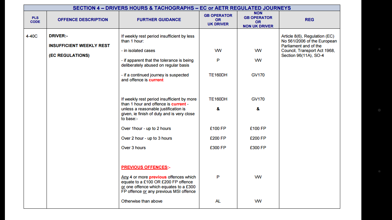

The way I read it mate, it’s Tacho (drivers) rules you’re breaking in the form of inadequate weekly rests…
You’ve taken 3 reduced weekly rests in a row!

As said, you’re breaking the EU regs.
If caught you’ll probably be parked up for 45 hours alongside a fine, potential court and tea and biscuits with your local friendly TC

Yeah you do. You have to take a full uninterrupted 45hr weekly rest every other week under EU drivers hours regulations. You should have had two in the last three weeks, you’ve had none. You’re breaking the law, so is your employer. If you get stopped at a roadside check you’re knackered. Expect to be parked up on the spot right there and then for 45hrs and then expect a fine and maybe even an appearance in front of the traffic commissioner as others have said which may see you lose your license.

If you get stopped by the DVSA any infringements on you’re card could land you with a roadside penalty.
In you’re case if you continue like this it wont be cheap.
