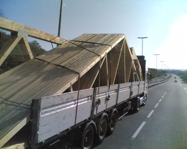

I didnt load the trusses and would never strap them like that, How can they be secure when the straps pass over the aluminium side boards? All that will do is bend the boards.
In normal circumstances I would agree but in the picture it seems that the side boards are tight against the load with no possibility of them flexing - or am I mistaken
I saw this one Rog and there were gaps as the rear posts dont fit flush. It was a bit of generalisation though, take notice how many flatback trucks, tilts, brick trailers and scaffold lorries have a strap passing over the side boards like that.
