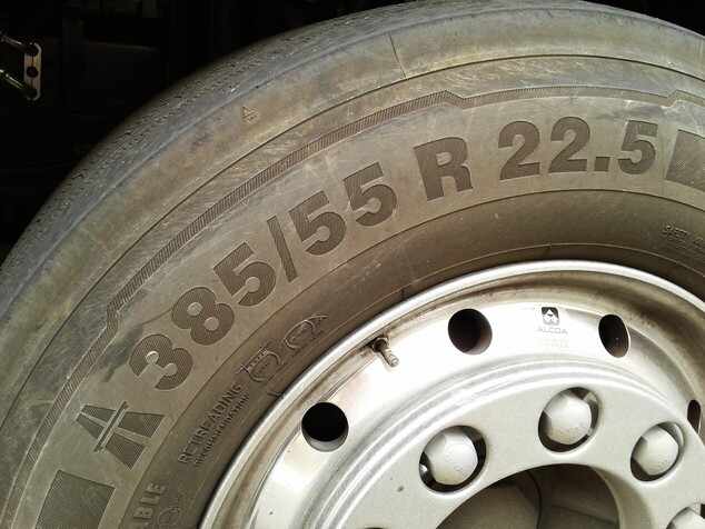

I have these on the steering axle. 8 ton front axle…
