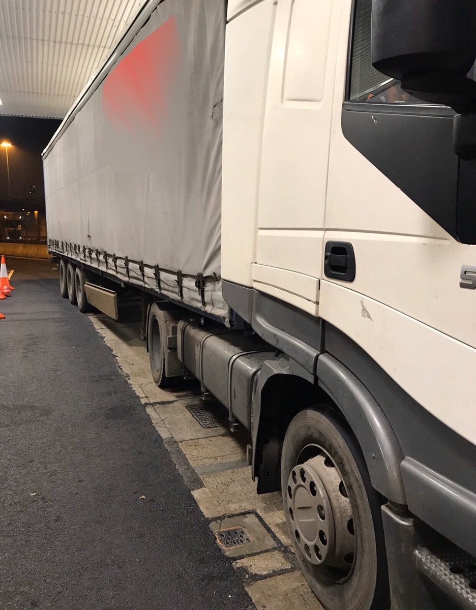

Cold Friday Morning at Dover Eastern Docks

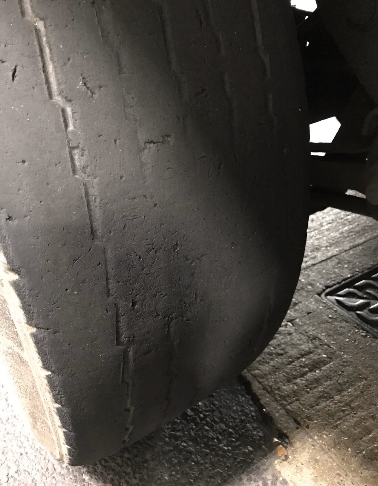

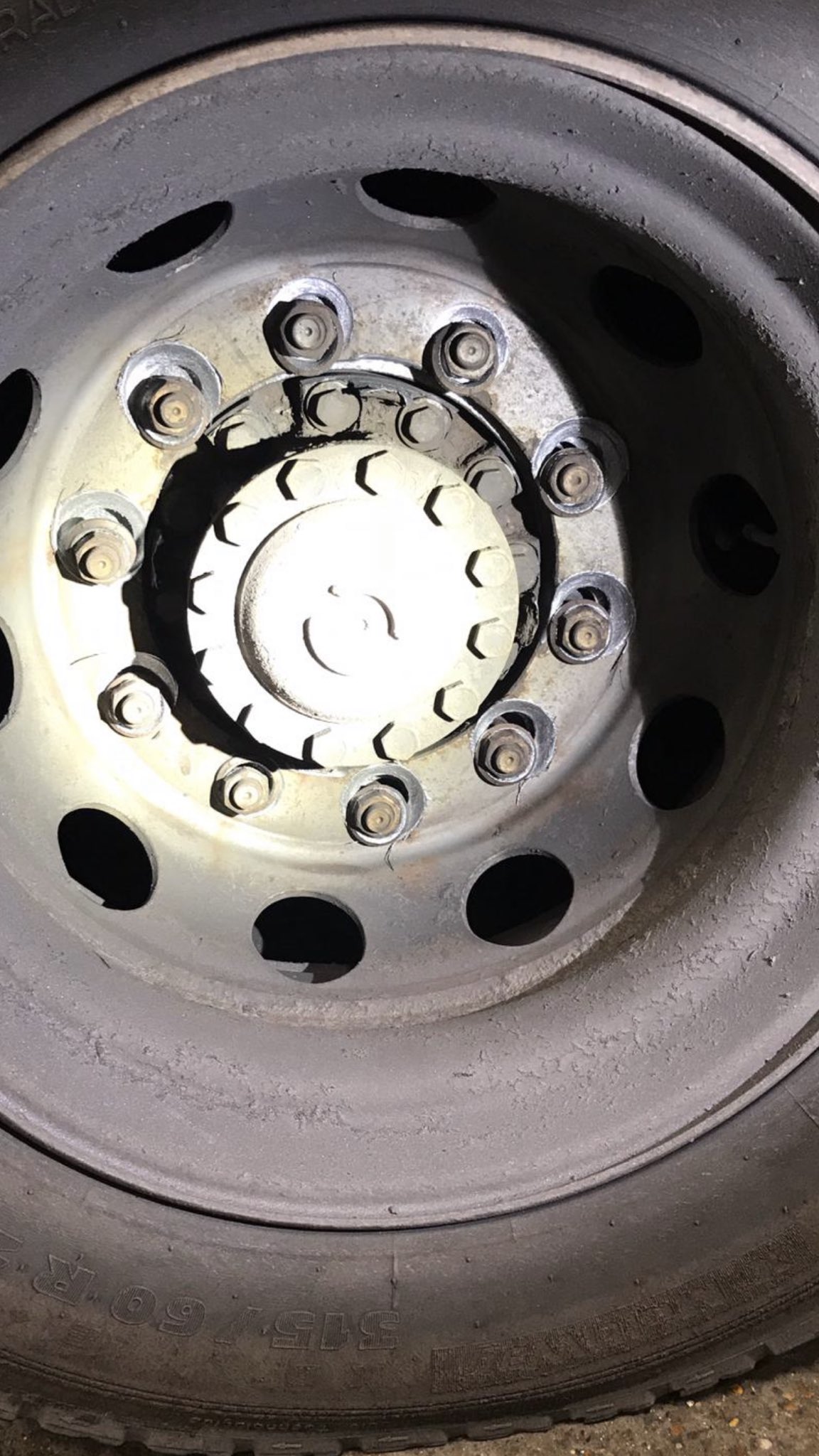

Our Vehicle Examiner spots this dangerous HGV
Drive axle wheel about to detach
Hub damaged, all wheel nuts and studs loose,2 brakes not working, trailer park brake not working, 4 illegal tyres & a broken steering joint.
Our Traffic Examiner discovered the driver not to be using a Tachograph driver card, No Driver CPC qualification & Tachograph not properly fitted
Driver & vehicle prohibited from continuing their journey
FPNs issued & vehicle immobilised

Micky wonders how you can check that, presumably he means the steering joint (though the play that alone must have created in the steering ought to have told him something) which was about to snap off and only the good Lord knows which poor sods would die horribly in the aftermath, meanwhile conveniently ignoring the slick tyres and wheel studs about to wear through the wheels

Those wheel
Studs have to be the worst I’ve ever seen. Ok, vehicle checks are the last thing the driver does I can see that but didn’t matey boy hear them rattling/clanging?

The foreigner stopped in the picture may well have to be low loadered away for repair since with a potential steering failure and loose rear wheels it can’t be front or rear lifted. The DVSA won’t specify who repairs the vehicle only that it must be safe to travel. Whatever happens will be expensive.
Old IVECO unit? Repairs very possibly costing more than the value of the unit.
Would DVSA allow a different unit to take trailer and deliver load? I guess so?
If its a traction only job....Whats the odds the driver will just try to walk away? Paper chase to find registered owner in a foreign country etc, awkward but possible, and needs doing to deter others.
