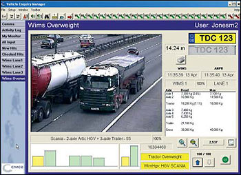

They mostly target overweight trucks, there is a WIMS system as you go past Clacket Lane services. They mostly stop foreign trucks which being 4x2 are prone to drive axle overloads.

toby1234abc:
There is a weighbridge under the tarmac that weighs the trucks while in motion in that area.
There are also weighbridge’s spanning all 4 lanes under Jnc 11 on the M20,so the vehicles pulled in to their place in Ashford is not at random.
According to Mr VOSA bod they can read axle weights up to 70mph.

Harry Monk:
What is WIMS?
I would guess Weight In Motion System
edit just read the link above, and I was right ![]()
