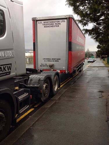

Oops!
Thetaff2:
Oops!
Oh dear oh dear. Unless it was prepared for one of them super lo ride tractors! :wink:

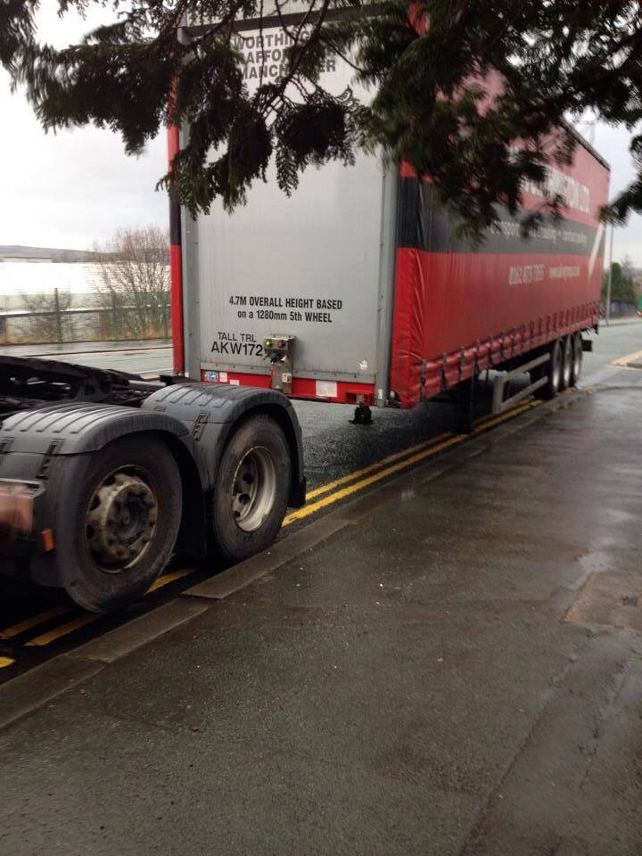

Here’s another…
What happened?
Looks like an uncoupling FAIL.

No idea I stole the photos off Facebook :grimacing:
Apparently it was a driver from Eastern Europe that dropped it.
Dounut!! But it’s something we all worry about… I seen a lad pull out of a yard I was working at got maybe a 100 feet and oooooops there it went now I check check then check again :wink:

I reckon you’d almost get that unit under that without any leg winding. Axle down. Drop suspension, drop trailer suspension, might just get get the lip higher than the back end of the riser rails.
Also I’m not sure that that unit is the one that’s dropped it. Surely it would have ripped the mud wing tops off?
