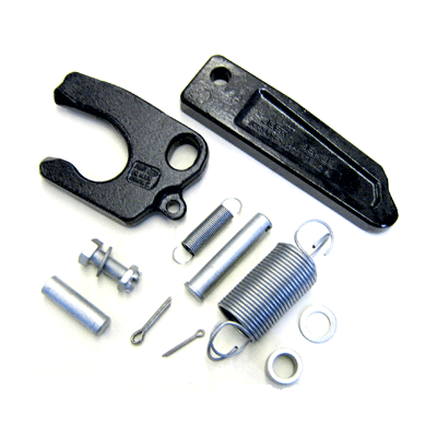

Granted this fifth wheel is not for this market but the piece of metal which you need to be looking at (assuming you are one who wants to check the fifth wheel this way) is the black piece of metal which sits behind the silver coloured horshoe in the fifth wheel throat.
This picture shows a fifth wheel kit and when a fifth wheel gets too sloppy, these parts are changed. When you reverse upto a trailer, the king pin makes contact with the horshoe which then in turn releases the fifth wheel handle and the springs pull the fifth wheel handle back into the closed position. Then as this is happening, the other piece of metal (pictured above) fires across and it is this piece of metal which locks the king pin into the fifth wheel.
Is it just me or does anybody else think its scarry all that weight sits on that little kit!!!

The plastic wearing rings are the main cause of failure and slap.
How many drivers do you see on a Saturday morning with a greasy stick?

Just for reference, if you click on the you tube link which was posted by micks, there are some more videos by Jost which show how to rebuild a fifth wheel…it’s not a complex task to do by any means but it too is worth a view as it will easily give drivers an insight into how these crucial pieces of kit work. It ai also worth remembering that just because there is “slop” in the fifth wheel, it need not be the fault of the fifth wheel - wear in the trailer king pin should always be taken into consideration as this, in my opinion, is overlooked.
