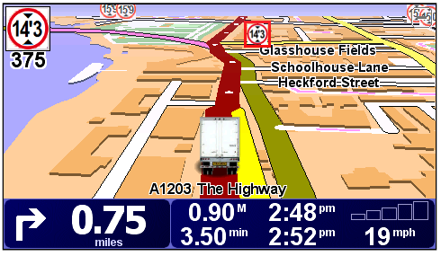

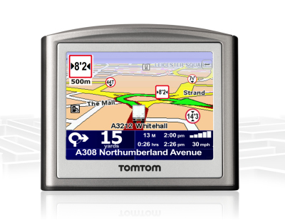

hello,bought one of theese tomtom truck 530 a couple of weeks ago of ebay and the thing keeps giving me routes through housing estates to get to destination, it avoids the low bridges and weight limits which is a good thing but theese narrow rds are a pain in the arse, but if i look on my atlas i can pick out the easiest and safest route for my truck withought going down theese narrow side streets, yes i have put in all weight restrictions and lenghth and height,width… igot a feeling ive bought a one with half the info for trucks after i select my profile truck.also any one else with a tomtom go 530 should the screen be showing the weight limits and bridge heights as in the pics ■■? because mine doesnt

thanks for the quick reply mate,i have got it on the “fastes route” and i have put in 50’ length but thats the route im getting through the housing est, does yours show the restrictions as in the pics when on route?

Yeah, its bleeps at me around 50mtres from the restriction/cameras.

What have bought is a go530 with a hacked (not official) map so it may not have been installed or have all the truck data on it the only official unit the co e with truckmaps installed if the go7000

The IQ routes only alters the route on programed historical information ie time of day to allow for rush hour traffic, mine is enabled and has never let me down, the screen shot on the original post don’t look like genuine Tom Tom, mine defiantly doesn’t show them (purchased from Tom Tom)
