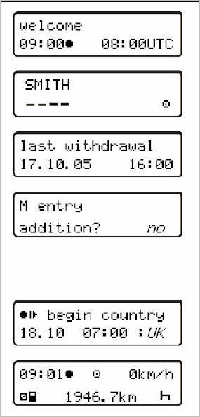

Hey I think my tacho may have a problem. I’m out with a mentor at the min with me doing the driving so my tacho is in slot 1 obviously but when i put it in on wednesday (first times the cards been in a machine) it didn’t say welcome or ask me anything just came up with the recording screen and yesterday it just said welcome and again didn’t ask me anything, nor when i took it out.
My mentors card is in slot 2 and that seems to work fine as it does when he puts it in slot 1. Did a print out both days and it seems to have recorded everything but just strange its acting like that. Anyone know if this just happens sometimes or there is a problem with it?

Re the tacho we’ve got twenty digi vehicles and I drive most, some do slightly different things. Some cards do slightly different things. Some take ages some don’t. Just remember to put the card into slot 1 first and eject the same. As long as the info is there from a card printout it should be fine.
Thank you both. Just abit concerned because what I was told would happen, didn’t happen. But as you said if its on the print out then yeah its doing its job i suppose.

Some of the options you get when inserting the card only lasts so long so if you put your card in and then took your eyes off it for a few minutes it would seem to have missed out the options but in reality it would have been you that missed it.
I’m not saying this is what happened just putting it forward as a possibility
