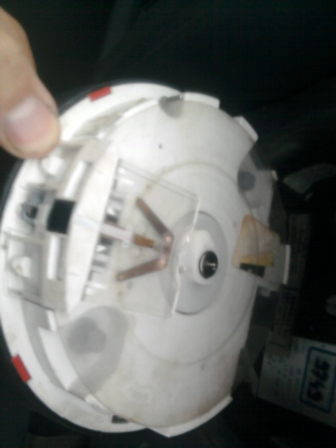

Hello all, Passed my test 26 years ago and drove a skip lorry on and of for ten years. Got offered part time work now with a 7.5 ton lorry.
I know the tacho disc wax side faces the needles but theres a small plastic flap inside the lid which has three copper looking connectors on it. Does the disc go under this?

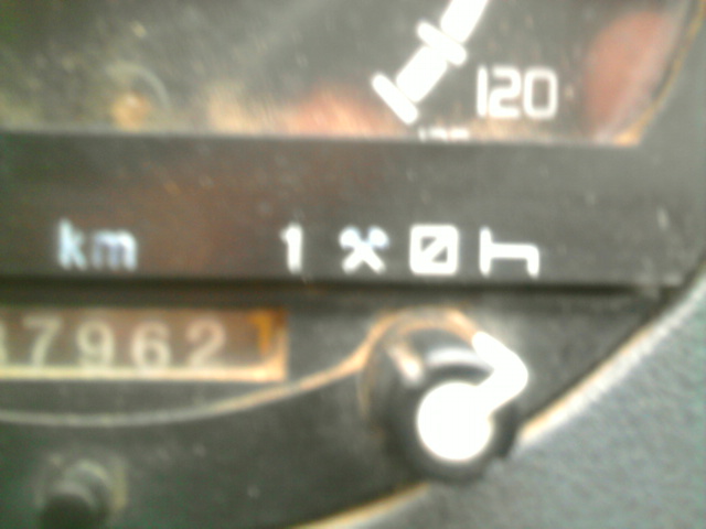

Also the switch outside has a chair for rest, two crossed hammers and a square with a line going from the top right hand corner down to the bottom left, theres no steering wheel symbol like on the old lorry.
What setting is for driving?

Put it on the crossed hammers and it’ll automatically change for driving.
As for where the disc goes, I think it’s under the brass whatsits

That would be the 2nd driver’s card.
You would place your card on top,without lifting any flaps,with the wax side facing the windscreen.
In pic 1 shropsbri I have to lift that plastic flap to get the disc to fit round the centre spindle, I don’t lift the plastic disc below that.

Crossed hammers = working
Bed (chair) = Break
Square with a diagonal line = Period of Availability (POA)
Whichever mode you have selected, the tacho will automatically switch to Drive (picture of a steering wheel on the chart) when the wheels are turning (and then revert back to your selected mode when you stop).
For ordinary 7.5 tonne delivery work, just set the switch to crossed hammers and leave it there all the time unless you are actually on a break, when you should set it to bed.
