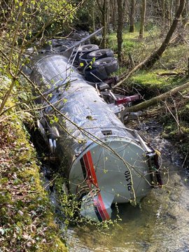

Semi-skimmed anyone?
Have Mansell Davies binned one?
twitter.com/mk1mr2/status/1382642790962757633
:laughing:
It looks like the barrel has come adrift, don’t look like a tractor unit has been recovered from in there?
A big fine on the way if it has wiped out all the fish,
Looks like a cream job.
That will be a mega insurance claim, I used to pull milk tanks when I was an owner driver. It was the most expensive part of my insurance, my broker said it was almost cheaper to insure a fuel tanker, fuel floats on top of the water, milk mixes with water and de-oxygenates it killing everything

Yes, this will be a serious problem, and so close after the big case were the TC nearly shut them down for falsifying maintenance records, and bad maintenance performance.
If there turns out to be a maintenance issue with this trailer, I can see them getting shut down. I’m sure that whoever’s they are pulling them barrels for, will have a quiet word with Gregories and Wincanton soon…
