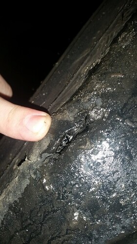

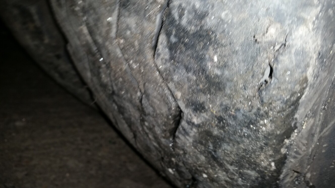

Thats the cut i went in today and got told its ok to run, i refused to take it out untill i had it signed off which he did eventually sign it in written,
Im fairly new to driving april this year im just trying to gain so much needed knowledge.
Jesus H Christ, that tyre is a disgrace! Is this normal at your place?!
Think you need to find a better employer.
Yes these are saying its ok because its not down to the wire, im trying to explain that in the middle of the cut is glass lodged in there, so its now a weak spot and could blow if that area hits a bump in the road,
Im ready for walking to be honest im sick of there ■■■■ they dont care about there drivers licences
Im ready for walking to be honest im sick of there [zb] they dont care about there drivers licences
Even without the cut I’m not sure id be happy taking that tyre out. But they are right, if it’s not down to the wire it is (usually) legal, but unless the glass is removed you can’t see if it is or isn’t. And poking a knackered tyre to remove a lump of glass really isn’t advisable
Think you should put this all down to experience and start on the hunt for a new job…
Looks fine to me, remove screw then crack on.
Superficial damage only.
Glass won’t hurt steel reinforced tyres, it’s not a cycle tyre. :wink:
Just remove any offending items with pliers and wear your hi viz.
Disregarding the glass for a minute that tyre in the picture looks in a shocking state anyway. Regardless of the fact that it may technically legal for road use you will find that first impressions are very important when dealing with the police or DVSA and that tyre would absolutely guarantee an extended stay at any checkpoint whilst they dig around for anything else to jump on you for, whilst at the same time guys in clean and tidy motors will be getting waved straight past you.
Don’t pop up on their radar if you want a quiet life.
Yet glass will cut rubber down to the wires, and depending how old the cut is the wires can start corroding so hey presto, buggered tyre, and if wires are showing that’s 3 points on your licence thank you please.
Edit: Also I’d never dig around trying to remove something wedged in deep, lives have been lost messing round with tyres.

Dipper_Dave:
Good advice above, there are 104 messages of condolence on the top of Old Timers page, that life was lost through a tyre :frowning:
Yep what’s a serviceable tyre to one driver is down right dangerous to another, always best to err on the side of caution.
No one can see the true damage underneath if in doubt get the fitter out.
I’ve driven on worse though :wink:

switchlogic:
Dipper_Dave:
Ah I’d not seen that. Once upon a time I’d jab around trying to remove foreign objects from tyres, that is until one of my brothers friends was blown to pieces.
Edit: Just had a look, was Saviem, such an awful thing to happen, he was always very entertaining and knowledgable
Don’t like the look of the tyre either wouldn’t be going anywhere if it was me on the first time i saw it,can see where the gaffers coming from its ok for 2 days now the same tyre isn’t on the third day,but tbh if it’s like that shouldn’t have gone anywhere the moment you saw it,as you said its your license if you get pulled.
I know you haven’t been driving long and keen to make a good impression and gain experience which we have all done (even those who reckon they know everything from day 1 lol ) but its a learning curve which takes time.
Yep if you have a screw in your tyre and start unscrewing it in the hope it hasn’t gone to deep or the screw isn’t to long the results can be anything from a non event to death or at least a nasty hissing noise.
For the sake of a few hundred quid get a new one.
Let all the air out of it when you are somewhere quiet well away from the yard, they will have to send a tyre fitter out then to replace it.
