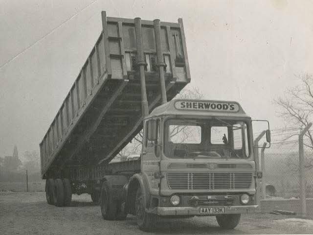

They were MOSTLY happy days. My first motor, 1959, was a Ford 4D (Harrisons of Dewsbury), next was Commer TS3 ( Fred Chappell) , moved on to my all time favourite, my AEC Marshall (5177 WY), next Atkis (150 Gardner), then various ERF’s, Fodens, and many more in between.
I enjoyed my life ‘on the road’, for me they were happy days.
