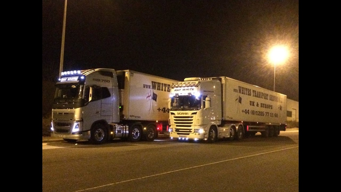

So go on then show us your Volvos.

22 trucks.

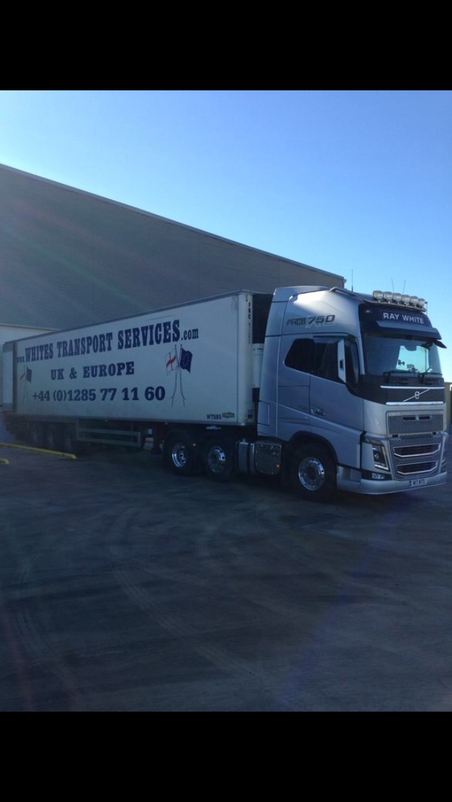

3 New Shape Volvos. 2 plain Spec 500’s and 1 FH16 750
6 DAF’s… Fairly plain to be honest.
The rest are V8 Scania’s…
