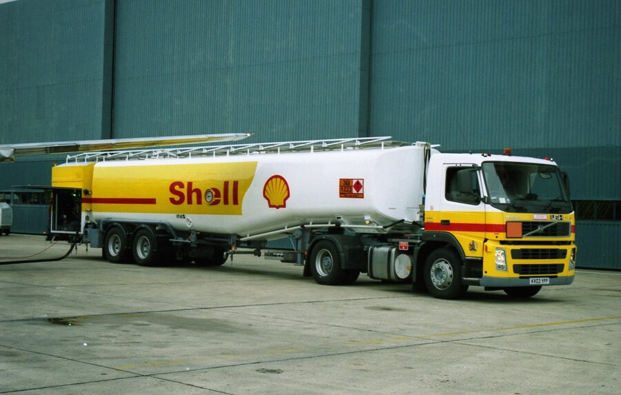

I just received this picture, featuring what looks like an aicraft fuelling truck. Its seems to be RHD, and so possibly British. At the rear, can be seen a grille; mayby the engine is rear-mounted, like on many coaches & buses. Would anyone have a clue?
It’s a Thompson Autotanker made by Thompson Brothers of Bilston. It’s Leyland based and rear engined as you suggest.
I’ve never seen one in the flesh, but I remember talking to an acquaintance who worked at Thomson’s Gloucester factory (they thought they were getting the build) who told me that the drawings showed the 680 Leyland as fitted to the Atlantean double-decker with a single driven axle. Apparently, there were plans to offer it with a Gardner as an option but I’m not sure if only the one came into being. That front entry door would never be allowed these days!
