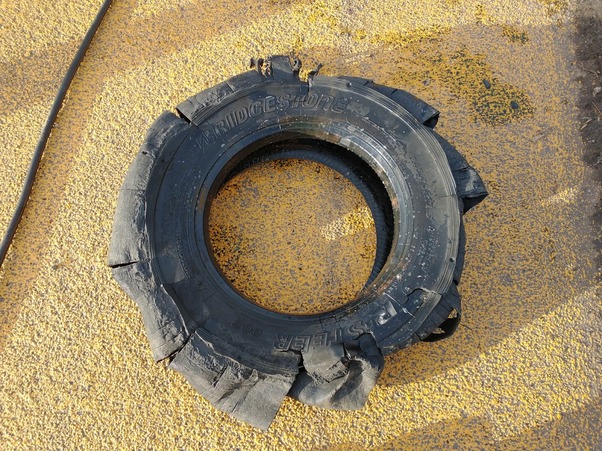

Posted image instead.

Oh what a surprise, a Bridgestone. Guy dragged my trailer I was taking onwards up to Scotland into the yard last Friday night with a Bridgestone tyre that just went bang for no reason when he was a few hundred yards away.

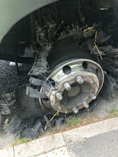

I’ve recently come back to driving after 6 years. And had a f/n/s blowout on my second trip out. Never happened to me before, thought I was going to die. Was on A38 nb at 56mph and thought I had hit something at first, then the whole shebang starts swerving and I was just passing a slip road with joining traffic so was trying to get over without wiping anyone out! Funny thing is the hazard lights were on when I stopped - so I must have done that. Could pinpoint when it happened on my Fitbit as my heart rate shot through the roof ![]()
Not sure why the photo is on its side - maybe I was in the recovery position
That was about 2 months ago and I hope it never happens again.
Daily checks■■? Those tyres must have been in a terrible state beforehand.
stu675:
Nope, I’m fastidious on checks - especially as I was still feeling my way back in to the job. Double-checking everything.
