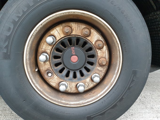

Missing nut.
A bit over the top if other 9 were tight :wink:
North West Motorway Police
@NWmwaypolice
One stopped today by the RCVU at Bowden Island, M56.
This HGV had a missing wheel nut.
In fact it was sheared off.
The driver thought it was acceptable and couldn’t understand why they was issued a Graduated Fixed Penalty Ticket and prohibited from continuing their journey.
I’m sure the DVSA would have mentioned it if it wasn’t safe but to me those new bolts look wrong for that wheel.
Anyway the driver will think twice before taking a lorry out like that again.
thats been loose for a long time and any good driver could see that .
He may have started the day with the stud and nut present, it happened to me once
Definite PG9 but he could have gotten a delayed rather than an immediate if it was just the one (see page 19 & 20 in the link), if he’d had any sense he would have said it was there on his initial walkaround check, but it sounds like he didn’t
assets.publishing.service.gov.u … efects.pdf
Difficult in a photo…but…looks like huge oval holes to me?
The rust streaks show that there is bare metal there.
JAKEY:
Absolutely.
Rust streaks dont appear on a day run. Anything out the ordinary is a sign summat is wrong. Dont ignore it.
Interesting that the DVSA Categorisation of Defects (IM6) says that MORE than 1 missing nut is an immediate and that one is a delayed! But, as above, zooming in shows the holes behind the nuts are all ovalled, so guess the PG9 was for that rather than a single nut missing.

The wheel doesn’t appear to be fitted correctly. The gap is non-existant between 3 and 6 o’clock but very wide between 8 and 1.
As already noted, this should have been spotted waaay before nuts sheared off. It hasn’t been checked at all for weeks.

It is worn away to *****!!

Top two aren’t aligned…

The stud holes are so elongated that the missing stud and nut has sheared, very recently, probably under braking, when great rotational shearing stress is applied to the studs.
I would expect that when the wheel is removed, the remaining studs will be severely eroded and the hub and wheel will be scrap.
The wheel, if it was not loose at the time the picture was taken, has been loose for some time previously, and had the nuts retightened after the damage was done.

What about the cut in the sidewall in line with the missing nut? Is that small enough to ignore?
