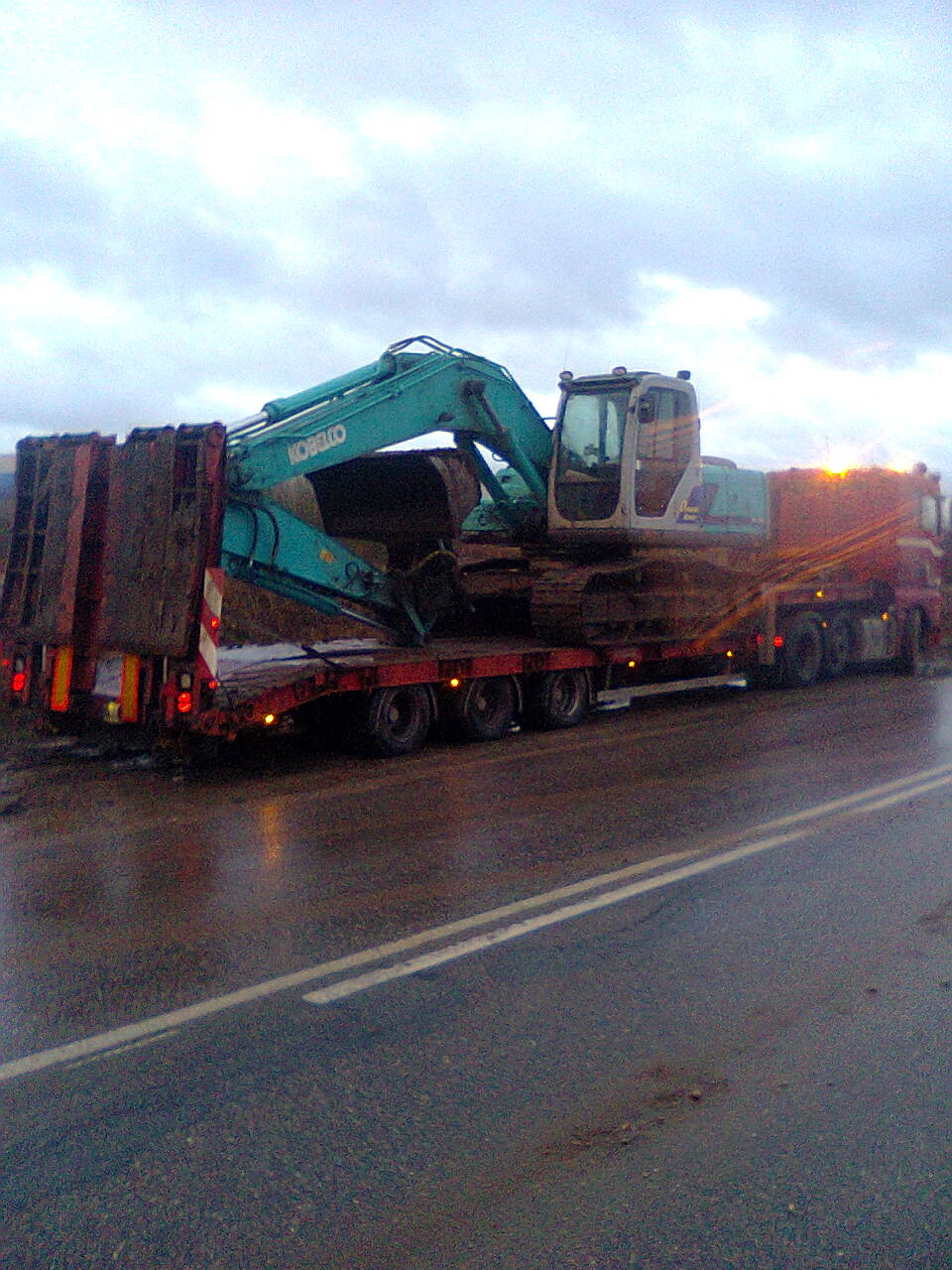

My ramp weighs loads for its size, thats why I dont like running with the rear axle up it bounces everywhere.
It has two stumpy legs that automatically fold out but also has a couple of bigger legs pinned up to help with bigger stuff.
I forgot to lower the bigger legs when loading this H70 (13 tons) and popped a ram hose
Thankfully it was fixed in half an hour
We often see ram hoses (hydraulic) and rams failing so I would never rely on just the hydraulics to hold a tail up

My ramp weighs loads for its size, thats why I dont like running with the rear axle up it bounces everywhere.It has two stumpy legs that automatically fold out but also has a couple of bigger legs pinned up to help with bigger stuff.
Thankfully it was fixed in half an hourWe often see ram hoses (hydraulic) and rams failing so I would never rely on just the hydraulics to hold a tail up

Mine are secured upright by straps.
Was dropping the ramps in another yard a few weeks back to load some plant and the weld on the bush that holds the hinge pin failed. It came down pretty quick although the between the ram and the other side it didn’t hit the deck. Had to drag it back upright with the crane and use more straps to secure it enough to get it somewhere for repair.
