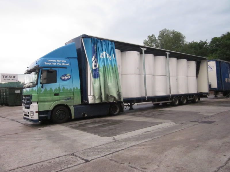

I saw one of these new long trailer today on the m6 at stoke. It was a kellogs trailer and it was being pulled by one curries motors
curryfart
you bore the absolute [zb] into me
So this thing is a few feet longer than a normal 13.6m trailer then :question:
What’s the big deal :question:
Before long everyone will be pulling one, just as things were when the length went up from 12.2m, as they did before that when the longest trailers were 33’ and before that when the biggest lorry was an 8 wheeler (with trailer) and way before that blokes pulled little trailers behind horses, it’s called progress and adding a few feet to a trailer is the logical way to do it, rather than making every tractor unit in Europe obsolete overnight as Carryfast (bless him) would have them do :bulb:

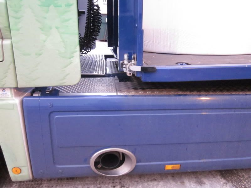

Dave Penn Only had a brief spin to a sort of induction but no doubt will fill in when somebodys off on nightshift ( Im permanent nights). Never had chance to speak to anyone but not heard any complaints. I think the dodgy`st part of it being low ride has an in cab button to lift the suspenion on unit for short sharp undulations, for instance we have a dodgy mini rounabout built into the middle of a hill when leaving Prudhoe it would prob rip catwalk off if you forgot to use the suspension.
@ greek, cheers mate, looking forward to hearing your opinion. I reckon they will be losing them catwalks sooner rather than later :wink: Coz them front trailer corners look incredibly close to the unit and only a bit of upwards articulation from the unit will put them in very close proximity to the catwalk. Lost a saddle-tank full of diesel once when working on the boxe’s and we were pulling the gooseneck type trl’s where the box had a cut out in the floor and sat in the front of the trl; and the pins went in at right angles from the front rather than from underneath :blush: :blush: :wink: luckily I wasn’t the first to have done it and diesel wasn’t as expensive back then.

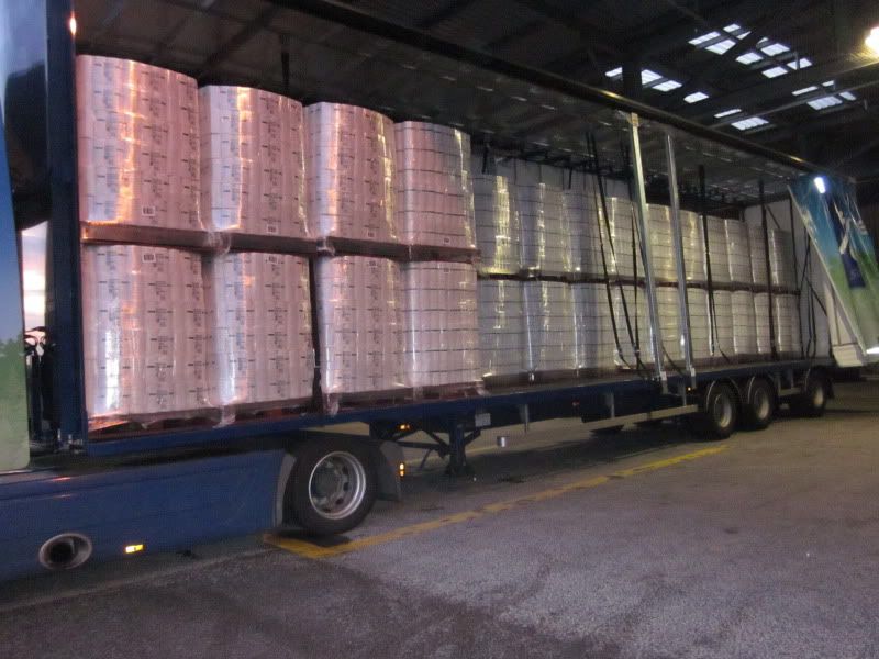

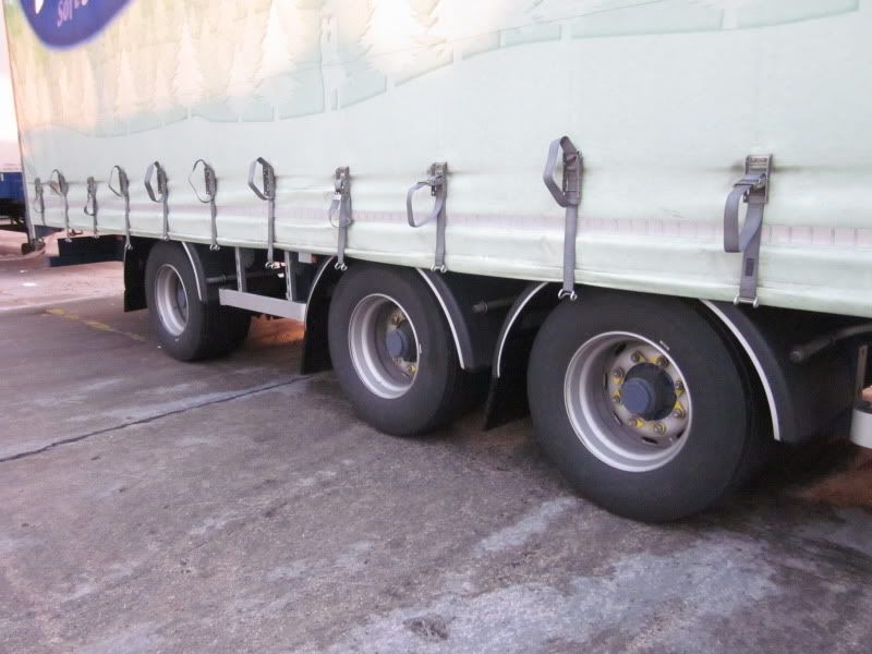

Got there eventualy filled in for someone last night. My initial reaction pretty good follows you better than normal 13mtr trailer in fact felt a bit like the drag its replacing & no swing on back end front end needs watching more with it being deep pin same as all close coupled.Reversing no prob but must be straight line for rear steering axle to lock which does so automatic, independant lock switch on trailer for shunting etc, Al in al seems a good design & works well only prob with this one is low ride & has a seperate cab switch for rear axle suspension on the unit to stop you ripping catwalk off on rough ground or severe undalations
Axle setup
Not much clearance
Outward load
Return load only 60plts not 90 this time
Only my opinion but don`t think it wiil be long before there in common use I would not have a prob going anywhere with them, maybe one or two loading bays & yards not designed for these lengths but that wiil change, looking forward to having a run with the normal height long trailer when it arrives. Sorry to disapoint carryfast but it does work :smiley:

If I’ve read it right you’re saying that tail ‘sweep’ with that overhang past axles 1 and 2 wouldn’t be an issue ‘anywhere’ in common use :question: and it follows ‘better’ than an ordinary 13.6 but there’s no difference between the pin to centre of axles 1 and 2 measurement which ‘should’ mean that it follows just the same as a 13.6 not ‘better’ :question: .
The fact is it’s around a 50 ft semi trailer :question: and you can’t just make the extra length disappear.It’s either on the overhangs,as in this case,so more sweep front and rear,or it’s in the middle so more cut in.If having loads of length on the overhangs was the way to go the North Americans would be running loads of 53 ft semi trailers with around Euro/UK type pin to axle measurements.But they know that having a lot of sweep is worse in most cases than having a lot of cut in instead.
