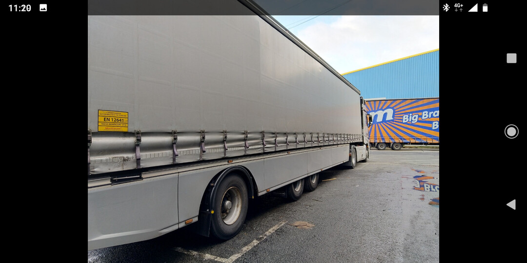

This is one of the trailers I used to pull…
As you can see, the distance from the pin to the first axle is longer than on a standard trailer. It doesn’t have to stay in the same place. I understand how rear steers work as I use them every day and in this case they compensate for axle 1 been placed further to the rear of the trailer. If all axles were fixed, cut in would be horrendous. The rear steers push the back end out eliminating tyres fighting against each other, so drastically reducing cut in.
Axle spacing are greater and also equal because axles 2 and 3 both steer and in doing so need more space, therefore ‘if’ extra weight ‘could’ be added it still wouldn’t take weight off the pin.
As for your productivity argument, if you take it to the extreme would that mean you’re in favour of Australian type road trains delivering bog roll to rdc’s as to get the tons/mile? ![]()
0As you can see, the distance from the pin to the first axle is longer than on a standard trailer.
Are you sure about that.Bearing in mind that not only doesn’t it look like it the law wouldn’t allow it because it would affect the cut in which has to remain the same.So as I said it’s compromised because anything behind that first axle starts to take weight off the pin and gets worse the further it goes back.So a waste of space on a tonne/mile/per gallon basis. ![]()
Yep. Quite sure. It ain’t much in the pic but I’ve seen it side by side to a standard tri.
The amount of cut in is reduced due to the steered axles. They push the back end out, steering it away from where it should cut in
hence why it LST’s conform to inner and outer turning circle limits
As for taking weight off the pin,how? The only way it would happen is if you were to put the heaviest parts of the load behind the first axle but the same’s still true of a normal trailer anyway ![]()
Johneboy:
The amount of cut in is reduced due to the steered axles. They push the back end out, steering it away from where it should cut inhence why it LST’s conform to inner and outer turning circle limits
Only all 3 axles contra steering would make any difference to the cut in assuming a longer pin to axle measurement.If axle 1,or 1 and 2, is/are fixed then axles 2 and/or 3 can only steer around it not push it sideways.
It’s clear that most/all of the extra length on that trailer is behind axle 1.
The fact that dropping weight on the extra load deck space behind that axle removes weight from the pin in addition to the gross weight remaining the same, thereby making it a waste of space in terms of tonne/miles/per gallon, is my point.
As for taking weight off the pin,how? The only way it would happen is if you were to put the heaviest parts of the load behind the first axle but the same’s still true of a normal trailer anywayOnly all 3 axles contra steering would make any difference to the cut in assuming a longer pin to axle measurement.If axle 1,or 1 and 2, is/are fixed then axles 2 and/or 3 can only steer around it not push it sideways.
CF you are so out of touch the rear does steer and push to the other side reducing cut in so much so it will hit obstacles on the other side, and weight distribution is the same as any artic don’t get involved in stuff you know nothing about
Exactly.
CF I know it doesn’t matter what I say to you in regards to how the trailers behave because I know you’ve already made your mind up, and as everyone on here knows, once your mind is made up it won’t be changed, whether you’re right or wrong ![]()
To further prove my point, I did go to the same rdc with both a standard trailer and a LST. The final roundabout was a right turn. With a normal trailer you had to ‘pinch’ a bit of the left lane going around or else the trailer wheels would mount the roundabout kerb. With the LST you could keep to your own lane all the way round. That was how effective the rear steers were in reducing cut in
, they track better than a standard trailer. Fact.
And the first axle was placed further back ![]()
As I said unless ‘all’ three steer then axles 2 and/or 3 ‘steering’ can’t possibly ‘push’ the fixed axle 1 anywhere. You’re obviously confusing tail sweep/swing with a proper STGO rear steer set up.Unless it’s STGO then standard pin to axle and resulting cut in rules apply.All you’ve got is increased tail sweep and an obviously longer load deck length behind trailer axles one and two which also means a totally different weight distribution regime.

Isnt the rear axle positively steered? If so this would push the rear round reducing the scrub on the other two axles.
