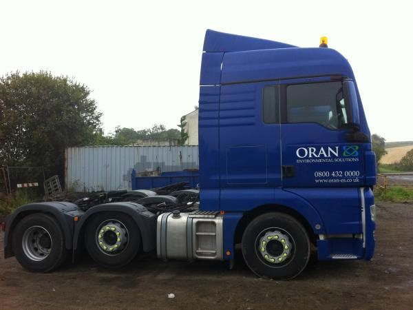

I’ve always wondered what these were for. What are the luminous little bits on the actual alloy of the lorry? What’s their purpose?

Sam, they are actually for spotting if the wheel nuts are coming loose. Note that two each point to each other, if the points don’t line up, you’ve got a loosened nut.

We call them checkpoints

These type in the photo are the best ones. If they dont align then the amber beacon on the cab roof starts flashing - very intelligent system :bulb:
