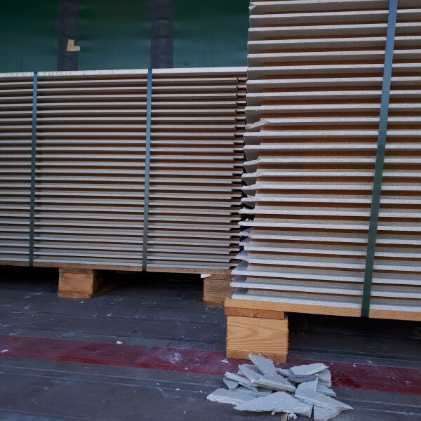

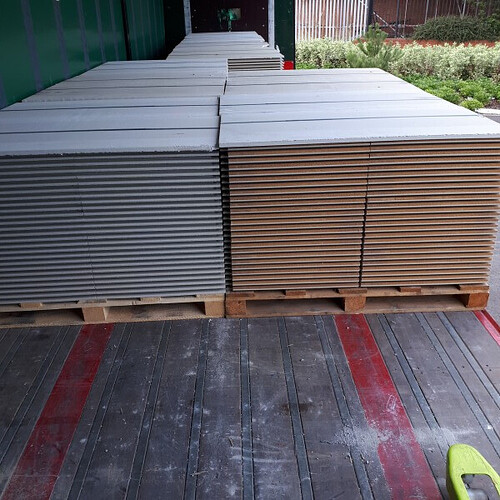

How can unload this?
Done 240 mile one way and refused and bring back this load.Refused because can be easy damaged when lifting.
Looks ok to.me.
Tell em they manged to load it on with out damaging it.

Telescopic Flt don t have side shift.They tsked one pallet and hsppened this
There’s drivers and there’s screw-drivers.
Same applies to forkies, as well as truck drivers. A telehandler on a rough site is more awkward than a small forklift on a smooth level surface, sure, but if the FLT driver can’t do it right…
I guess the problem is the boards slide around and slip under each other? If using a telehandler, maybe they could tap them to the side slightly then very gently just get under the pallet and drag it backwards?
Suspect its more the telehandler driver is independent of the contractor using these and couldnt be arsed with taking the time to do it in a fiddly way. They usually seem to be seriously in demand.
Better loading trick might be to put a sheet if plyboard between each set both side and back which would stop any pallet to pallet movement. But thats upto the sender to sort.

My point was a proper telehandler driver would manage without a sideshift, as Trev explained. May be more time consuming, but there you go.
Edit. Strap around pallet block and drag it out a few inches before lifting.
You need a proper Forkie and a decent FLT to do the job properly.
NOT the job for some ponceabout with a gas truck with his forks practically touching in the middle… :unamused:
Grab a strap,wrap it round the pallet itself(the wooden thing at the bottom) ,other end attached to the forks and drag it away from the one next to it then bobs your uncle drama over!
Looking at the first pic, why have they started unloading from the front?
Start from the back, steer forklift right so pallet moves left and out you go.

You can move a pallet sideways with a telehandler, just reverse back with whichever steering lock you need, and extend the boom as you do so. It takes a bit of practice but it can be done.
