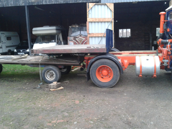

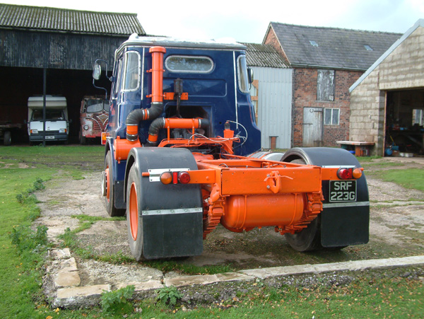

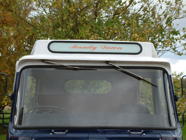

Back on the road after a long rest rotting away
looks great more pics please, fredm
Looks a top job, but please can we see some more piccys!
hey, nice LV,but why is the exhaust at the front,or was it for ADR.
Here on the continent long before the ADR regulations we had them for gastankers.
Bye Eric,
Looks a super job, tractordriver. Get the camera out again, please.
Tiptop, front-mounted silencers were, I believe, optional on early LVs but standard here in UK on later ones. 3300john will probably tell us if I’ve got that wrong, but I’ve driven an 8-wheeler and an artic with front-mounted silencers, both G-reg. My last LV was J-reg (1971), also with front-mounted pipe, as were our other four of the same vintage.

Hiya…yes i would think 99% of silencers was across the front…its with sweet sounding engines that was so quiet you could
look for smoke to see if the engine was running or not…er hum… heres a good one the Aluminum tail pipes was made
from flat sheet, I would cut roll and Gas weld them, then hammer them round. i think their was 6 different diameters on
various models. I would make 50 tail pipes in a week.formed aly wasn’t around in the right diameter. looking back god knows why
they didn’t change the outlet pipe on the silencer to suit the tail pipe… Ho well its 45 years ago now why worry.
the restoration is a very nice job someone has spent alot of time doing that…
John
Hi, John. At least the ally tailpipes didn’t rust! It was just a matter of re-shaping with the Birmingham screwdriver if anyone happened to clobber one.

A very nice restoration job Sir ! So what is the exact spec, 180 LXB/DB6spd/Eaton axle ? Cheers Bewick.
150 LXB - eaton axil yes 6 speed DB yes

I will put a drop plate on her to tow a caravan and may be a flat with a tractor on it
