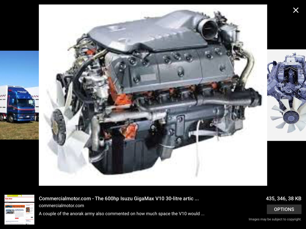

Anyone got a link to details of that Isuzu 30 litre V10 (IIRC) tractor unit please, naturally aspirated running some 600hp i believe, now that would make short work of pulling out on busy roundabouts, make short work of just about anything, give me eye teeth for one of those.
If I had the money Juddian, I’d sort that for you coupled to an Arsetronic gearbox! :grimacing:
In me best Albert Steptoe voice…‘‘you horrible little bleeder’’… :smiling_imp:
Seriously the Japanese are far too clever/sensible to fit an unfit for purpose pile of dung like that into a proper working vehicle, anyway the torque that Isuzu pushes out would probably rip the thing apart so yes, stick one in and i’ll tape the gearbox detonation and post it on the tube. :laughing:

30litre Isuzu V10. With 600 horses and heap and heaps of torque
