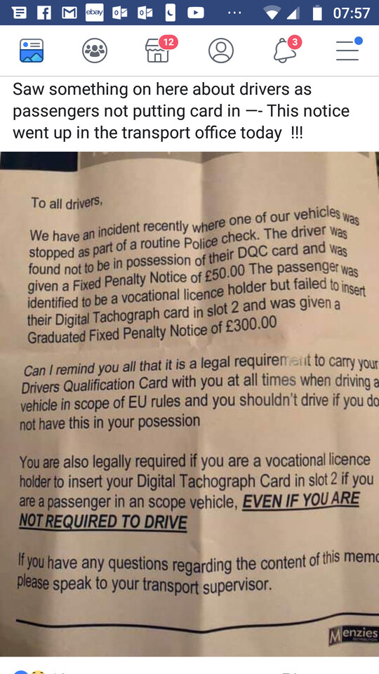

Just seen this on facey
stevieboy308:
Ah well, looks like they’ve dug a bit deeper and found yet another good excuse for a reason to extort money out of us,. :unamused: … and put another nail in the coffin of a job as a truck driver. :bulb:
I can’t for the life of me think why the job attracts far fewer people to what it once did…anybody??
Money grubbing twisters!..
The driver was found not to be in possession of their DQC card, even though there’s a ■■■■■■■ database with everyone on it. We have systems that monitor car insurance and MOTs but the first opportunity to fine a driver and the ■■■■■■■ are onto it.
If there’s two of you in the cab, chances are you’re gonna get stopped now. For example, once Spanish police worked out that if they measured car transporters from the overhang of the last car, they could class the vehicle as overlength and fine the driver. As soon as one area started doing it and making money, within weeks every copper in Spain cottoned on to it.
Might as well just stick it in slot 2 and save yerself half a weeks money.
