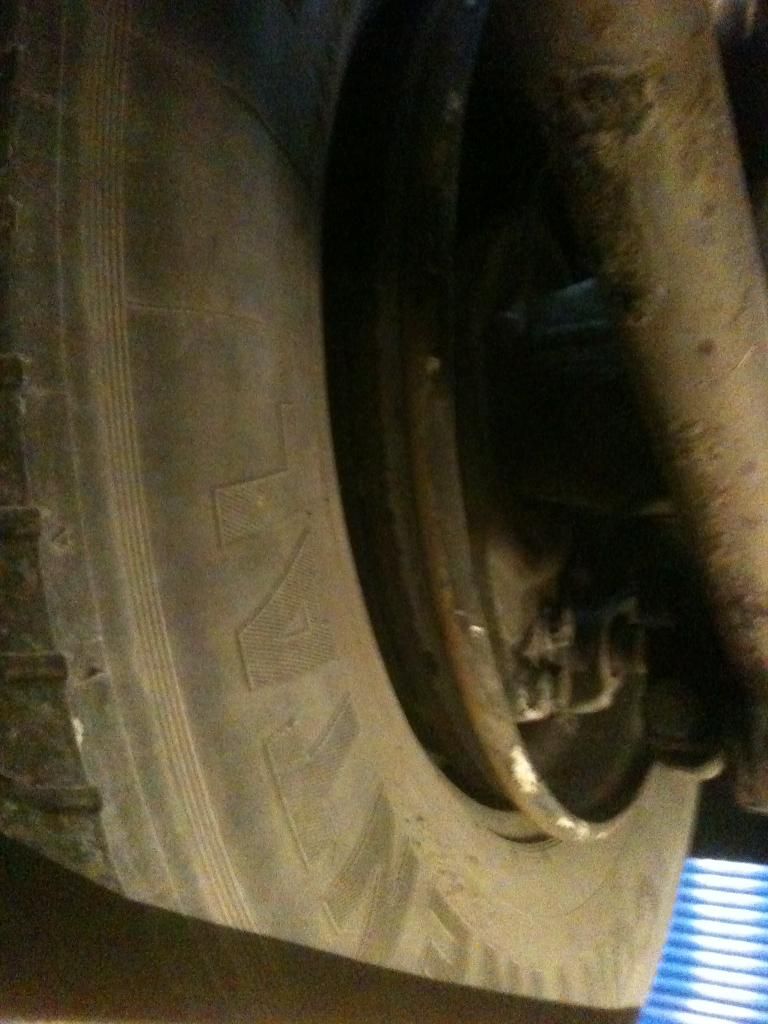

I would say the wheel bearing myself on this one Lol. Also seen this when the brakes stick on and melt them.
BUT ITS THE WHEEL BEARING.
Cheers Peter
It was a seized caliper. Vehicle brought in for MOT, tester logged on vehicle came back out and found this.
