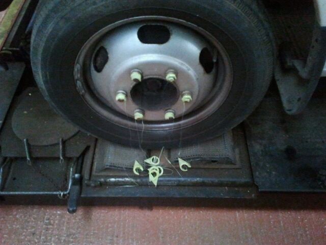

Spot the defect:
Wildy:
Spot the defect:
Garage heater blowing on wheel :slight_smile:
Wildy:
Spot the defect:
The wheel nuts are loose because none of those markers are pointing at each other. :smiley:
been sarcastic i would say that chocolate wheel nut indicators arent the best but generally i would believe the hub/brakes is getting a smudge hot

Wildy:
Spot the defect:
I would say the wheel bearing myself on this one Lol. Also seen this when the brakes stick on and melt them.
BUT ITS THE WHEEL BEARING.
Cheers Peter
