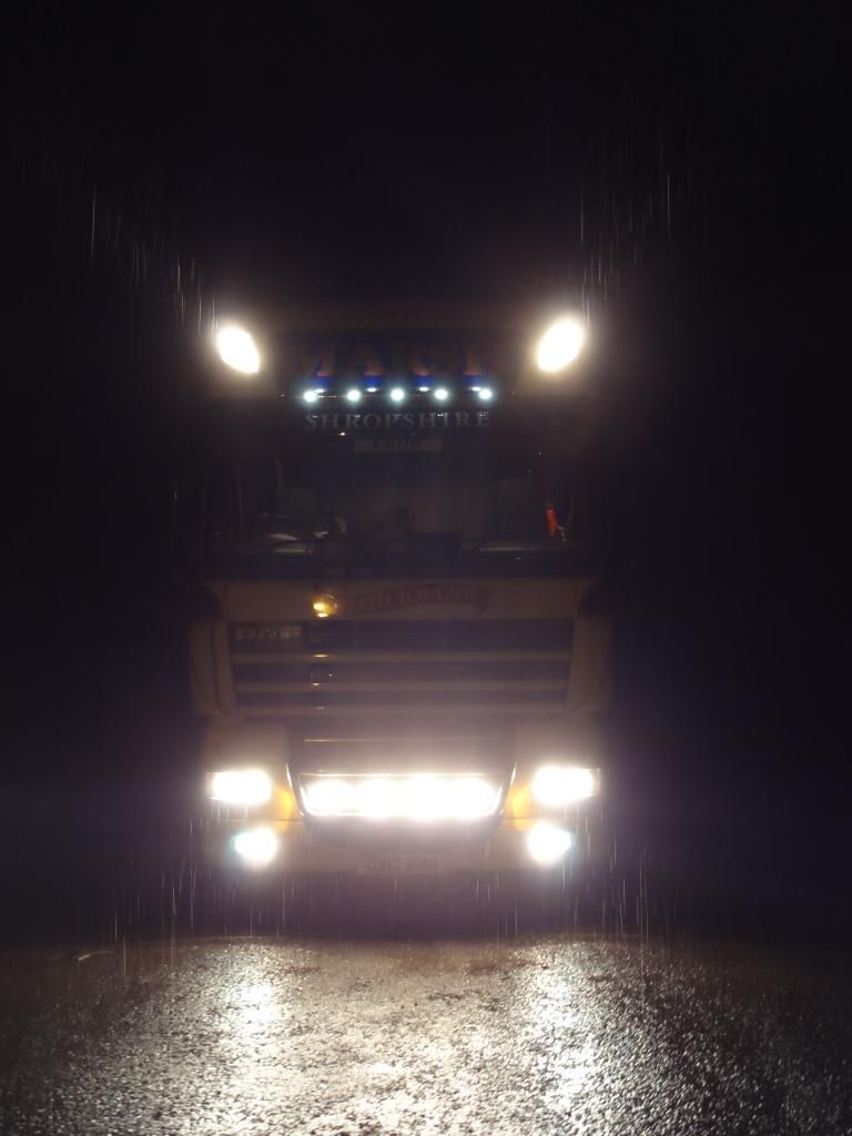

Done mine, all thanks to Dave.
Mine has dealer fit combi’s in bumper but our 61 & 12 plates have the fog light with blank behind the other light lens deal going on! Is that factory fit?
Not gonna tell them how to do top lights as I’m selfish like that :stuck_out_tongue: lol
