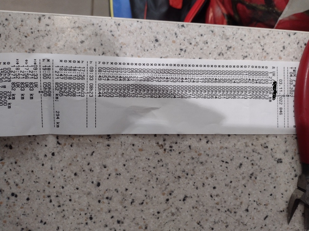

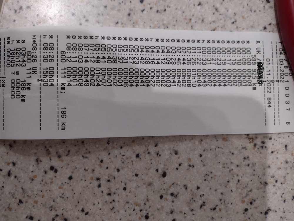

sorry for the delay with the print outs but this is a weird one i have clearly had enough rest on both days so why the hell it should generate an infringment for not enough daily rest (8h17 continual rest) is beyond me
1/11/22
2/11/22
3/11/22
to my calculations i had 33hours 20 min rest between the end of my shift morning of the 1st and start of the next shift on the 2nd. I also had 9 hours 7 min rest between the end of my shift ending on the morning of the 3rd and starting again in the evening.

I can see a daily rest of 8h 23m on 3rd November?
From the readout you left your card in on rest at 07:57 for 44m of break, then took your card out and added in 8h 23m of rest until 17:56 where you put your card in for another three minutes break before switching it to other work at 17:59.
Collectively that’s 9h 10m, but its been broken twice. That maybe it?
toonsy:
it might be however i sure the infingement said 8h17 and i was careful to check the tacho display on the dash and the unit and both said over 9h.
thing is none of these issues show up on the card reader when i download my card at the end of the shift. There are only 2 on there both of which i agree with.
You seem to have ejected on break and reinserted and added some more break.
Perhaps the tachograph software considers ejecting as work so the break needs to be one solid total of break.
The 8h17m is probably achieved by subtracting off any break taken after 17.50, because that was your start time the previous day. So 8h23m minus any time after 17.50 (six minutes).
Essentially either leave your card in or eject for the whole daily rest maybe.
Edit: I do agree that you have taken enough rest/break, 9h01m within 24 hours of when you last started a shift.
