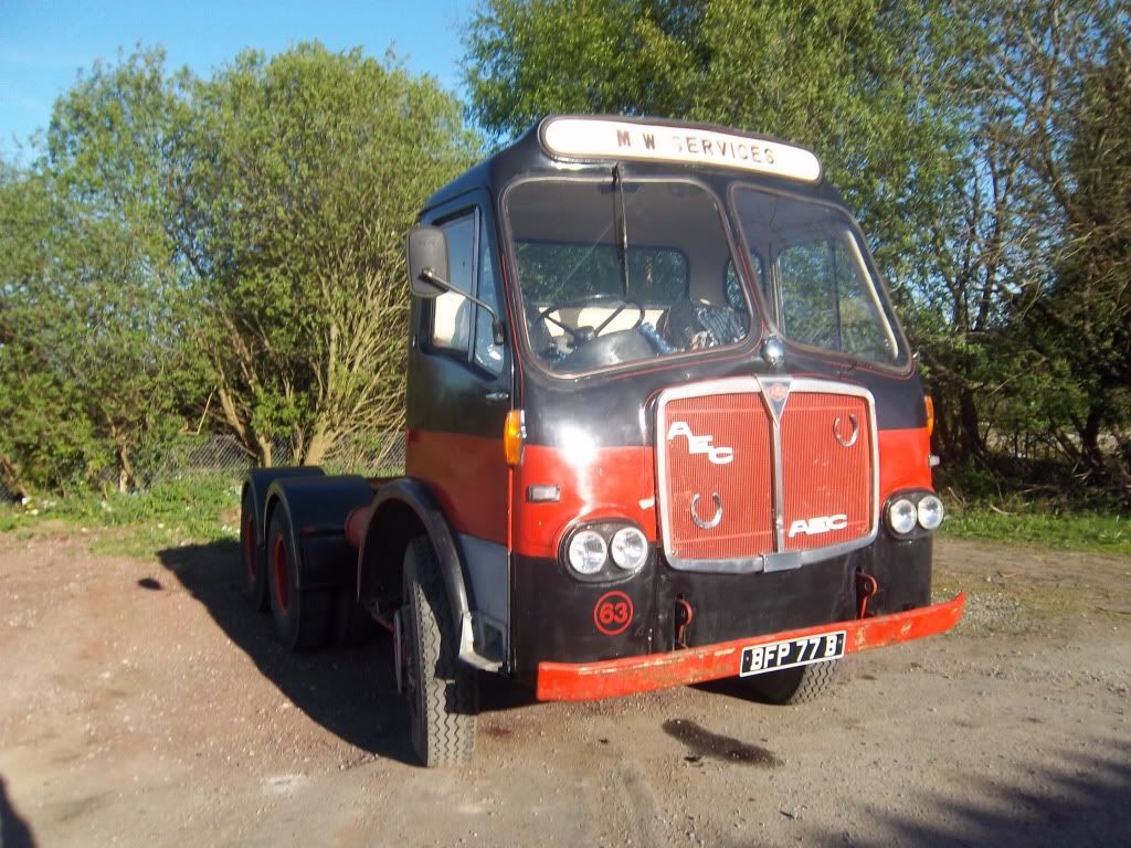

Hiya …update number ■■? what do you think of the horseshoe muckaway
the diffs are in and a new windscreen new headlights just the handbrake to sort out
John

She’s looking well now John,nearly ready for work. :smiley:

Chris Webb:
3300John:
John
John it looks like you’ve had Harry polishing it for you what a shiner :smiley: :smiley: :smiley: :smiley:
Regards Keith
Hiya dessert driver…Harry did’nt do any polishing he was saying you missed a bit here and a bit there.
truth is i poped into that chap across from castle cement on saturday morning and he cut a screen for me
(beauty of having a flat screen)so while he did that, i did a little elbow grease did the back one side and a
bit on the front. it come up not bad.so sunday i had to do the rest.I’ve only wasted an hour…
will you be at llandudno next week■■?
John
Hi boys
Yes John hope to go on Sunday for a nose will look out for you
Regards Keith.

Hi John it`s looking well,what engine is in it 11.3 and a 6 speed box ,does she drive well?
Hiya …11.3 with a 6 speed box…the new diffs make her do 46ish in 5th so its better than the 42mph
flat out she did before.
John
3300John:
John
Is 6th an overdrive? should give you a decent top speed,with the double drive it maybe an old heavy duty unit so the need for the low diffs , my dad had a 1959 8 wheeler mkv and drag with a 9.6 and 5 speed it did 38 mph flat out full load of wool on it was very sad and with the canopy over the cab heavy steering too

Hi ramone…when i got the diffs the other week John who sold them to me said on the motorway
dump trucks they wanted the lower diffs… they was carrying 25plus tons of soil
and over 30 if it was heavy clay on unmade roads… when wimpey ordered a batch of mm6’s they
all had high diffs but had the 760 engine…they was back ordered and then AEC/leyland
released them in the early 70’s…the diffs i have come from a 1970’s mm6 which had been maked
Leyland…it still had chrome hub caps and the front wheel bearing covers was stamped Leyland.
if you look at the Halfcab mm6 that has leyland covers that have been on since new.
no its not a replacment hub its a replacment cab…i would think we’ll manage almost
200bhp and only 8 tons…its much better 45ish on tickover in overdrive…6th
John
