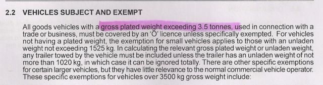

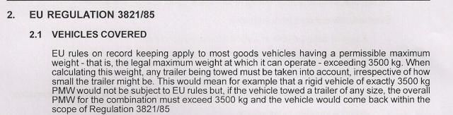

Unless the law has recently changed, here are the relevant sections from my (December 2012) Operator’s CPC training manual.
I missed this post somehow, thanks Harry, please ignore my post saying you will clear this up.
global.
Operators Licence.
“In calculating the relevant gross plated weight or unladen weight, any trailer towed by the vehicle must be included unless the trailer has an unladen weight of not more than 1020kg, in which case it can be ignored completely”
So, if I read the above correctly when the trailer has an unladen weight of not more than 1020kg it does not need an Operators Licence.
I have previously driven a 3.5 tonne (gross weight) flatbed and a flatbed trailer with an unladen weight of 750kg and yet capable of carrying 3.5 tonne gross. This combination would still be exempt an ‘O’ Licence if I’m reading it correctly.
