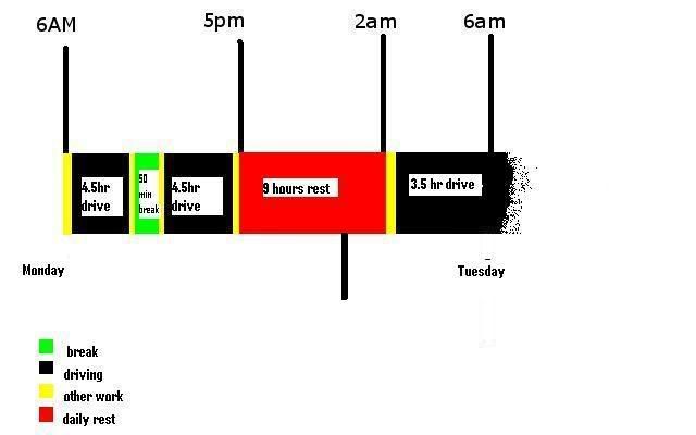

This would not be an unusual shift for me. And i make it that my first day,daily driving period or 24 hour period (Monday)was only 20 hours in length. I’ve started my second day,shift,24 hour period,driving period or whatever you want to call it at 2am. I know for sure i have started my second days work ![]()
I also know i have driven for 12.5 hours in a space of 24 hours.
You don’t find shift examples like that in the VOSA/DfT handbook !!
Mike-C:

Mike-C:
Stuff starting at 2am, thats still the middle of the night
I’d take an 11 off and start at 4, or have another 45 break, do another hours drive and then have 9 off plus 15 minutes and start at 4.
I’d do either of those for 2 reasons, 1. 2am is still the middle of the night - nights are for sleeping, days are for working. 2. a 2am start makes that day a night shift, restricting me to 10 hours work (we don’t have a work place agreement to bypass that

I’m well aware its legal Malc, i wouldn’t do it other wise. I am demonstrating that a daily work period, daily driving period, days work,shift or 24 hour period is not always neccesarily a real full 24 hour period. And conversley it is possible to work two 24 hour periods,shifts,daily driving periods,days work and from beggining to end the time the real time time lapse can be(for example) 54 hours. If anyone can get their head around that fact they may realise therefore that six 24 hour periods do not neccesarily constitue 144 hours.
I think when i said previously that in the UK its no big deal as VOSA will allow it, the fact is if some one has a bump and god forbid there’s a casualty then they’ll find out the hard way that there’s no 144 hour limit and you can squeeze as many shifts as you like in. Like everything, read the disclaimer at the bottom of the advice offered.

So what you’re really saying is
From 6am (when your 1st shift starts) to 2am (when your 2nd shift starts) is counted, in the legislation, as 24 hours. Because you have done some work (a full days driving plus a bit of OW) and taken a daily rest period.
When your 2nd shift starts is the start of another 24 hours.
If you should work your complete week with shifts that start earlier and earlier (a totally ridiculous scenario, it can’t be possible to start before 2am, surely ?). After 6 shifts you’ll have to take a weekend break, even though the total number of hours will be far less than 144
Because each work shift plus daily rest, is counted as 24 hours in the legislation.
Mike-C:
I like this as it clearly shows the two seperate regulations in article 8.
6am to 2am is this one as it fits WITHIN 24 hours - before the next 6am
- Within each period of 24 hours after the end of the previous daily rest period or weekly rest period a driver shall have taken a new daily rest period.
6am to 6am is a 24-hour period - maximum of six (consecutively) between weekly rests
- A weekly rest period shall start no later than at the end of six 24-hour periods from the end of the previous weekly rest period.
If this was the first shift of the week then these 6 X 24 periods end at 6am Sunday.
