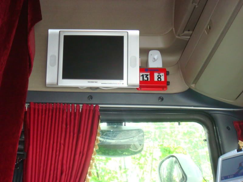

I got a 19" dvd freeview/dvd from Currys when i was in Glasgow last year, £190, it was a household one not a 12 volt one i admit, it went in a Super Space Cab Daf, on a proper wall bracket, the wire from the socket ran down the side wall of the cab (hidden up out the way) into a 300 watt inverter that was screwed into the bit that seperates underneath the bottom bunk with bottom rear of the passenger seat. Whenever i wanted the telly on i just flicked the power switch on the inverter and i was away, 300watt was no problem at all and quite happily coped with a PS3 as well as telly.

I bought a normal house wall mounting bracket for 19" telly mate (i believe It was £11 from Currys when i got the TV), in the Super Space Cabs there is a shelf that runs above the passenger door, basically i screwed the bracket into back of TV, sat it on the top of the shelf so it took all the weight, marked where the holes neded to be and stuck a small screwdriver thru the marked spots being careful not to make the holes bigger than the screws that came with the bracket, then fixed it in. As i said, the shelf (storage pocket) takes the weight of T.V and all the bracket has got to do is actually hold the T.V up straight. It sat there with no trouble thru some old Eastern European countries on some bad roads and was solid as a rock. You will have to remember to take it out when the cab gets tilted for servicing thou!
Im not over familiar with the FH layout (its been a few years since ive been in one) so not sure as to where the best way to fix it is as im sure they dont have the shelf above passenger door. At a guess id say if the bottom bunk still doesnt lift up i would fix it at the end of the bed…
Surprisingly, this is the only pic ive got that has the T.V (or at least a very little part of it) in but you get the idea.
