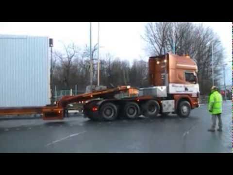

or 3 axle unit and 3 axle trailer, combined transport £650 per year ![]()
I’ve a 7 axle w&d and have no IDEa what the tax is cos i don’t pay it ![]()
