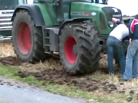

C-KAY I used to worry about snow and ice. Like you I went on to artics with only a couple of months summer driving in rigids. I heard some horrific tales of driving artics in winter, but common sense and the advice given above will see you through. good luck, I’m on holiday at the moment and I’m hoping they’ve fixed the night heater while I’ve been off. That by the way is called wishful thinking :laughing:
And if you do get stuck the last ten seconds may make you think VERY carefully about being pulled out with a tractor and chain…

http://www.youtube.com/watch?v=OZqERllOYlI
LHD is much safer
