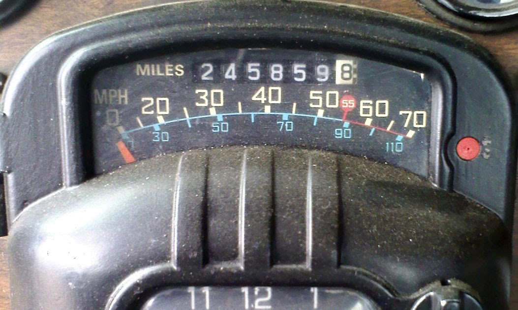

Theres an old tacho at the above link, (cant post the picture keeps saying not allowed) looks like a 1930s style although theres not much info.
There’s ways and means around everything. :wink:
Very nice, Art Deco I would say, probably dates from around 1935?
Thanks H (again :wink: :smiley: )
Just noticed the mileage…not bad for an old '30s or '40s truck
