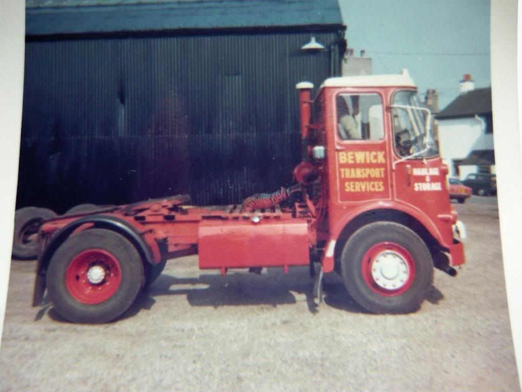

Does this side view of a 10’ 8" WB Atki Borderer help any ? The 5th wheel is a York Big D which was our coupling of choice for many years.
hey to all, The big York was one of the best but very expensive and here was Jost the common used. For the long trailers we had first the 1.20 and for the new after '84 the 1.45 and 1.60,and some are set even more backwards with cut corners.The wheelbase depend of the manufacturer and you had a choise for longer if you wished. the fifth wheelsetting was a bit own choise, but was a regulated but after the first MOT lots moved it a bit we had a 15.5m max long reg and had the 12.5m (41 FT) trailers,and a 13 tonnes driveaxle which gave a bit play and about 3FT space between the tractor and trailer was comfortable.
