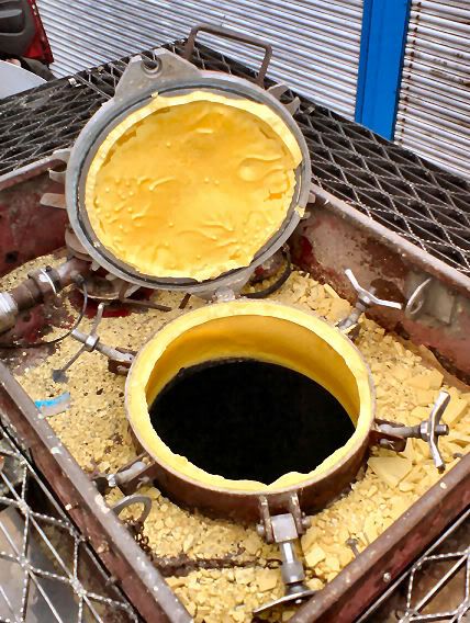

In the best traditions of this programme, here’s one I prepared earlier… :grimacing:
A sulphur tanker sidemarking:
And from the rear:
And for my last trick,
Here’s a sulphur tank with the manlid open

I am nitpicking again. I believe the Hoyer fleet number is wrong as it should be VFH 63 which stands for Very [zb] Hot as Molten Sulphur is carried at about 140’c :laughing:
In addition to that, the Crane Fruehauf manlids and boxes are a right proper mess, and you are never going to steam the drains clear on them. Norman Lewis would be personally kicking your arse through the gate, never to darken them again :laughing:
Wheel Nut:
Hi Malc,
You can nitpick all you like mate, cos it’s only by doing so that things get discussed. :stuck_out_tongue:
Wheel Nut:
Now there’s a thing… I’d never have left a spill box in that state, so he’d never have kicked my arse. :grimacing: :wink:
