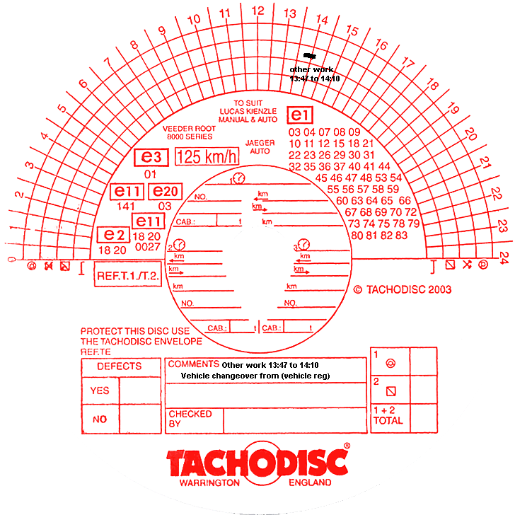

Have been driving this morning using Digi card when come back to depot they ask me to drive somewhere else using different truck that had old tacho.
What I have to do know with the old type tacho■■? I did print out today from digi, do I attach them together or I have write something down somewhere■■? :open_mouth:

You didn’t need to do a printout really, all you need to do is to ensure that any time spent away from the vehicles such as when you were changing over is recorded manually on either the printout or the chart, so if you do a manual entry on the chart to cover any time spent changing over vehicles you can bin the printout and just keep the chart :wink:
I don’t know how to write that on old style tacho maybe will be better for me to keep both of them there was 30 min waiting time betwen finishing on one truck then going to second one, didn’t do anything apart from sitting and waitng to tell me how many pallets to pick up. So how would you guys sort this out■■? Can I just kepp both of them with out writing anything■■?

On the back of it mate.

Depends on weather or not you will be using the driver card again tomorrow.
If you will be using a digital tachograph tomorrow before going out on the road in another truck you can enter a manual entry onto the driver card.
For digital tachograph instructions including manual entries see this thread.
If you’ll be driving a vehicle with an analogue tachograph then you will need to write a manual entry on the chart or printout, failure to do so could get you a fixed penalty if stopped :wink:
See pages 31/32 for instructions on manual entries on charts.

No not manual entries on charts, I put a picture of how to complete a chart in this thread but not a picture of manual entries.
I’ve just checked and the penalty for failing to do manual entries can be either a verbal warning or a fixed penalty of £120 depending on the circumstances :open_mouth:
So it may be worth getting the pen out :smiley:

lets make a bit easy to understand start driving and working at 6.45 am finished 1.47pm then waited got the second truck and start driving at 2.10 pm till 5.10 pm
so if some one could give me clear instruction what to do■■?

If you can wait till tomorrow then I’ll do the bit on the back of the manual chart, scan it, then post it on here for you

Were you TOLD that you would be waiting for the second truck - if yes I’ll do it as POA or if no then I’ll do it as other work
when I got to depot they ask me if I want go so yes I new I had to wait but not for the truck the truck was there I had to wait for information where to collect how much and waited for my paperwork so I belive this will count as POA but I’m sure if I’m wrong you will correct me :smiley:

does not seem a specific wait time so I’ll do it as other work - won’t make much difference as it’s only about 15 mins
Do something like this and you should be fine but to be honest it would be easier to do a manual entry on the digital tachograph when you insert your driver card.

[ZB] tachograph - I’ve just spent time doing one ready to scan :exclamation: :exclamation: :laughing: :laughing: :laughing:
mine was not as fancy as yours though - How did you print that on it■■?
Sorry for been thick :blush: I understand now you only have to make not on the chart about the change over nothing else
