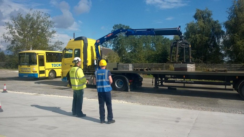

This picture shows two more drivers Steve is training today!
Half the pallet of bricks near the headboard now put the other half on top of those… I remember it well :smiley:
He could of turned around and gave us a smile for the camera, he must of been concentrating to much. :laughing:
