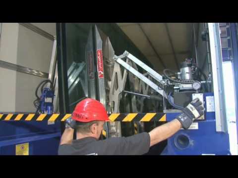

hard to explain but they have a box body on them but there seems to be about 3 ft of clearance between the wheel arches and the trailer wheels them selves, just wondered what those trailers carry…

I think what your talking about are used to carry sheets of glass
Do you mean one like THIS :iF SO AS POSTED BEFORE ITS A GLASS CARRIER
Robertthegreat:
If so, they are called Innenladeren or singular Innenlader.
They have a large frame inside that rides on rails.
The driver puts the trailer into position then lowers the suspension on the trailer. This places the rack on the ground and then they open the back door and pull the trailer forward, leaving the glass sheets on the rack behind.
I’ve looked for a vid on it but can’t find one, but I hope that give some insight into the question.
That is of course if the above link is the trailer you mean, ![]()
EDIT: The nice member below has posted a superb vid of this one.

Cor aint that clever.

That’s bloody amazing.
Although these trailers appear to be triaxles, they do not in fact have any “axles” as such.
The wheels and suspension units are each mounted independently each side of the trailer,
leaving the centre of the trailer completely clear, this also explains the sturdy construction
of the rear door which adds integrity to the strength of the rear of the trailer.
The trailer in the vid. is carrying only two packs of glass, but I have seen them carrying
four packs and occasionally six packs - very heavy.
Craneage is essential for unloading, sheets of glass this size are impossible to handball.

they are also used for moving large slabs of concrete for prefab buildings, there’s a company in belgium (the name escapes me at the mo) that sell complete houses to be moved to spain in pieces we load the stuff that fits on a 2.4m wide trailer but the slabs that are say 3m wide can be put in these glass trailers on their sides
leaving the centre of the trailer completely clear…
Many of these suspension units are made by Tridec in Holland, Tridec was sold to JOST in 2008 iirc. Tridec was owned by Ton Van Haughton (SP) who previously owned Esteppe!! Very very clever man and nice as well!!
tridec.nl/tridecsite/engels/ … index.html
Many of this type of suspension units where used on Tescos early doubledecks and more recently citylink 'deckers. The common ones used for ‘normal’ ones used are the LV O model. If anyones interested Tridec also supply the command steer for the city trailers that Tesco run, look on the link in the left hand column.
