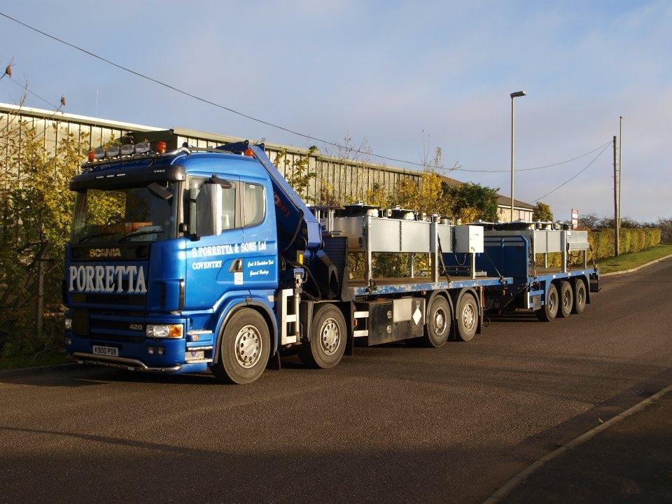

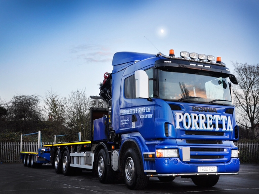

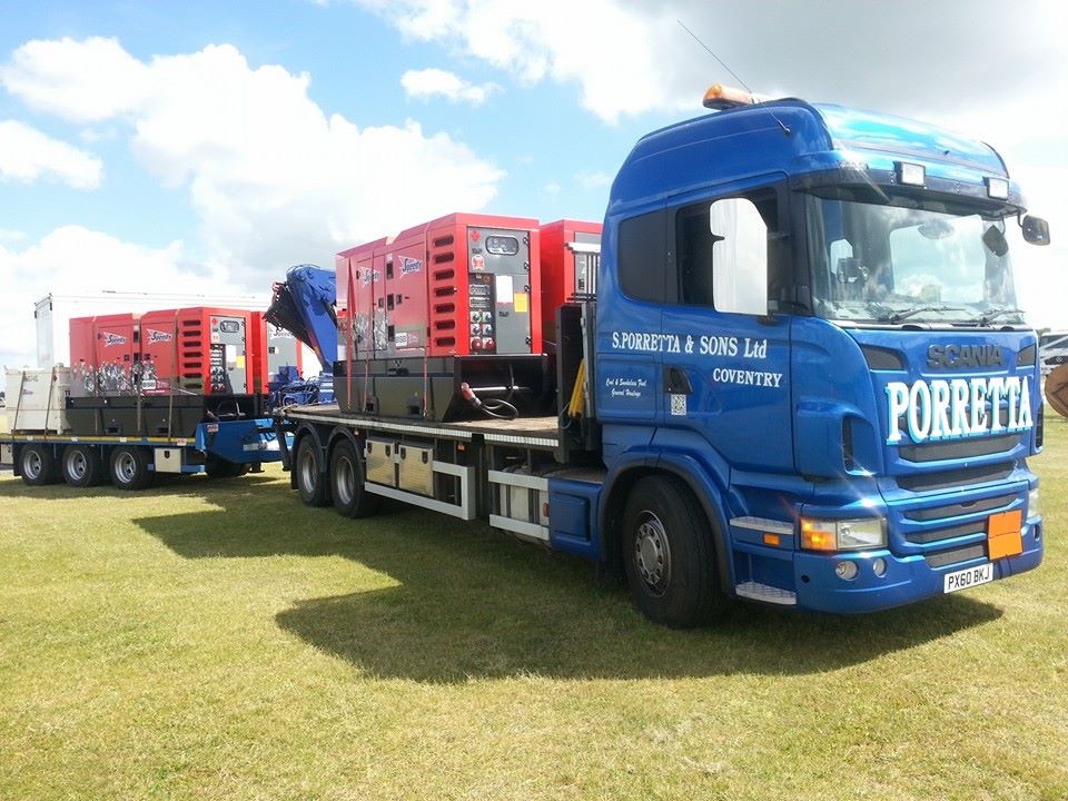

We have 4 W&D’s with another one on they way. Only 1 is a 6 wheeler. Mine is the oldest, 4 series 8 legged. You get used to it. I rarely drive the 6 wheeler but when I do, I always find myself ‘over-manoeuvring’ it. I prefer the 8’s, but that’s probably because I drive one.
A few pics of some of ours.
Mine.
6 wheeler
One of the other 8’s.
