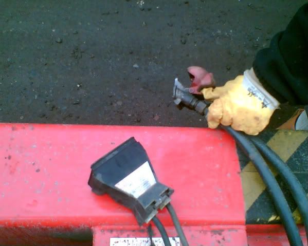

Some trailers use C Type couplings and susies like an artic, some are automatic which clip together.
Duomatic air couplings
Sod, it, here is one we did earlier…
