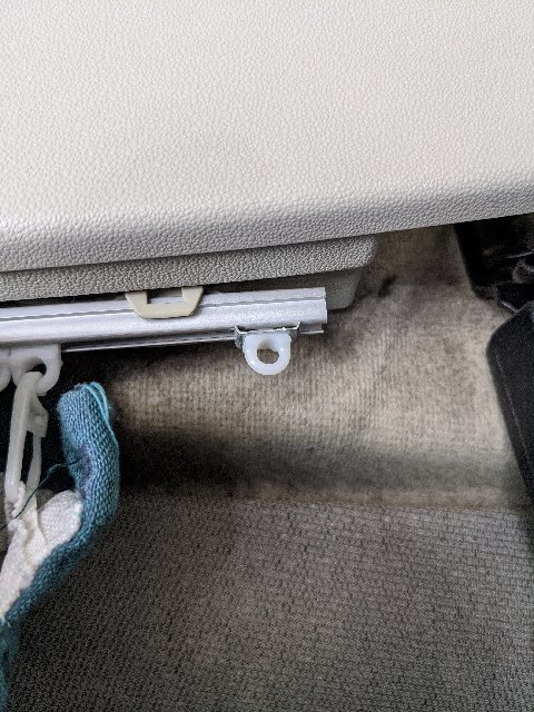

Hi all, just started for a company and been give a 15 plate FH. The curtains have a few of the hooks off the runner and i cant figure out how to get them back in. Ive tried getti g the end cap off the runner to no avail. The hooks are a square type so any help greatly appreciated
Twist end Hook 90°, slide out, slide in hooks, put end back in Twist 90°

The FH has an end stop, same as a Scania, twist it 90, then it’s out.
Chances are the hooks are snagged, 1 of the tabs usually snaps off them, that’s why they’re out of the rail. It’s an easy job to replace them, and you can get replacements at most truckstop shops or online.

Well had a look and it’s like a rubber bung in the end of the runner and can’t figure out how to remove it

V4, twist 90’ remove.
V3 slide out the plastic bung.
Looks like the bung has been butchered on mine so will have to find a work around
