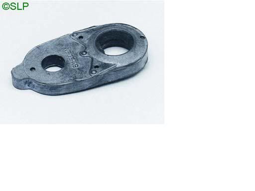

So here is the bonus question.
What is this?
That’s an easy one Mr. Nut.
It’s a water seal, they went between the cylinder heads, most 6 cylinder engines had 6 seals, although i have seen a couple where there was not one fitted between the front of number 1 head and the thermostat housing, thus requiring only 5.
They were fitted simply by pushing them into place with your thumb or a soft tap from the end of a hammer handle and removed by prising out using a thin bar through the top hole.
It was amazing how many people would re-use them after doing engine work, then wondering why their expensive antifreeze was running down the side of the engine…They were cheap enough to renew each time.
